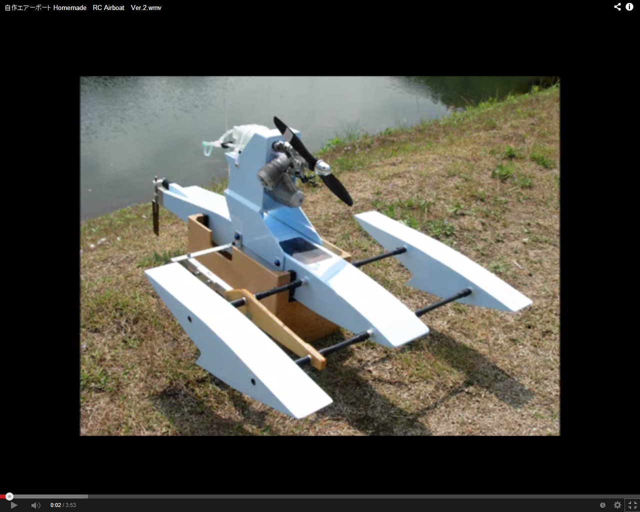

You have a valid point for discussion, and I'd like to contribute to that.
There is a trend, a pattern that exists which has it's roots quite deep in the history of the aero engine, I've touched on this before here. If you take a grass roots functional full size airboat we are lead to the superb vehicles which are the only way to access wetlands in many parts of the world, and if you consider the means of controlling those your almost bound to result in a rear engined craft. Air rudders demand that flow, add the simple practicality of vision and the driver being out of that airflow then rear it has to be.
But, to me almost exclusively to modelling, front engined boats are proven to be the most efficient when it comes to converting thrust to speed, and this predominantly developed in Europe. Tethered airscrew hydroplanes represent the fastest airboats on a thrust to speed ratio basis of any type, including real ones, and has been around since long before practical RC control came into existence. It is a simple fact that in regions where real airboats are used there is a tendency to head towards rear, even when the control method does not use the thrust, i.e. water rudders. As the sheer volume of such boats knocks the specialist European Hydros into a cocked hat in numbers the dominance of rear engines is easy to explain.
Right now, there is a gap of enormous proportions between the effort that's gone into the development of rear engined boats and the specialist minority of airboat's specifically designed to be efficient, but it is going on in certain quarters, resulting in such current beasts as this:
Closer to your thoughts there have been attempts at front engined craft that use thrust to lift the boat by allowing propelled air to get under the hull, effectively a force fed tunnel boat., indeed some are almost working on a Ground Effect principle. But I've not seen reasons why these craft have not come to the fore.
So I guess those those looking for a speed experience to nth degrees use forward engines, but those that like to share in what is a more traditional way will pretty much automatically head to back engines because they enjoy that as part of the real airboat experience, and those folk form the vast majority of airboaters.
It's a hobby, fill your boots, do what gives you the fun and if that be pursuing forward engines and seeing if that can go up a level from where it is then I'm with you, let's do it

Hi Jeremy_H Clearly I'm not alone in my thoughts on this idea. Is that your boat in the pic? I never considered a rigger with an air engine. Please understand I meant no disrespect to anyone's design or a person for what interests them in this varied hobby of rc merely exploring alternatives with available means of propulsion. I have seen some interesting creations here at rcu and it can certainly gets ones creative juices flowing that's for sure. I have built a 48" hydro and placed a 75 supertiger (inverted for lower CG) just behind the front sponsons at about 2 degree's up thrust and to be honest it scared the heck out of me, scary fast, too fast for fun unless the aim is to create the fastest water dragster. It was estimated to be over 70 mph in seconds and to my astonishment it actually worked with no sign of lift off, blow over and seemed to be exceptionally stable. Have you or anyone else experimented with this concept?, what was the outcome?, anyone have pic's of their creations?
Old 01-16-2014 | 04:45 AM
Joined: Jan 2007
Posts: 8
From: , UNITED KINGDOM
No offence taken at all.
The blue boat is a screen shot from youtube, I'll dig out the vid link plus any pics of some of the stuff I mentioned.
Do you have any pics of your boat?

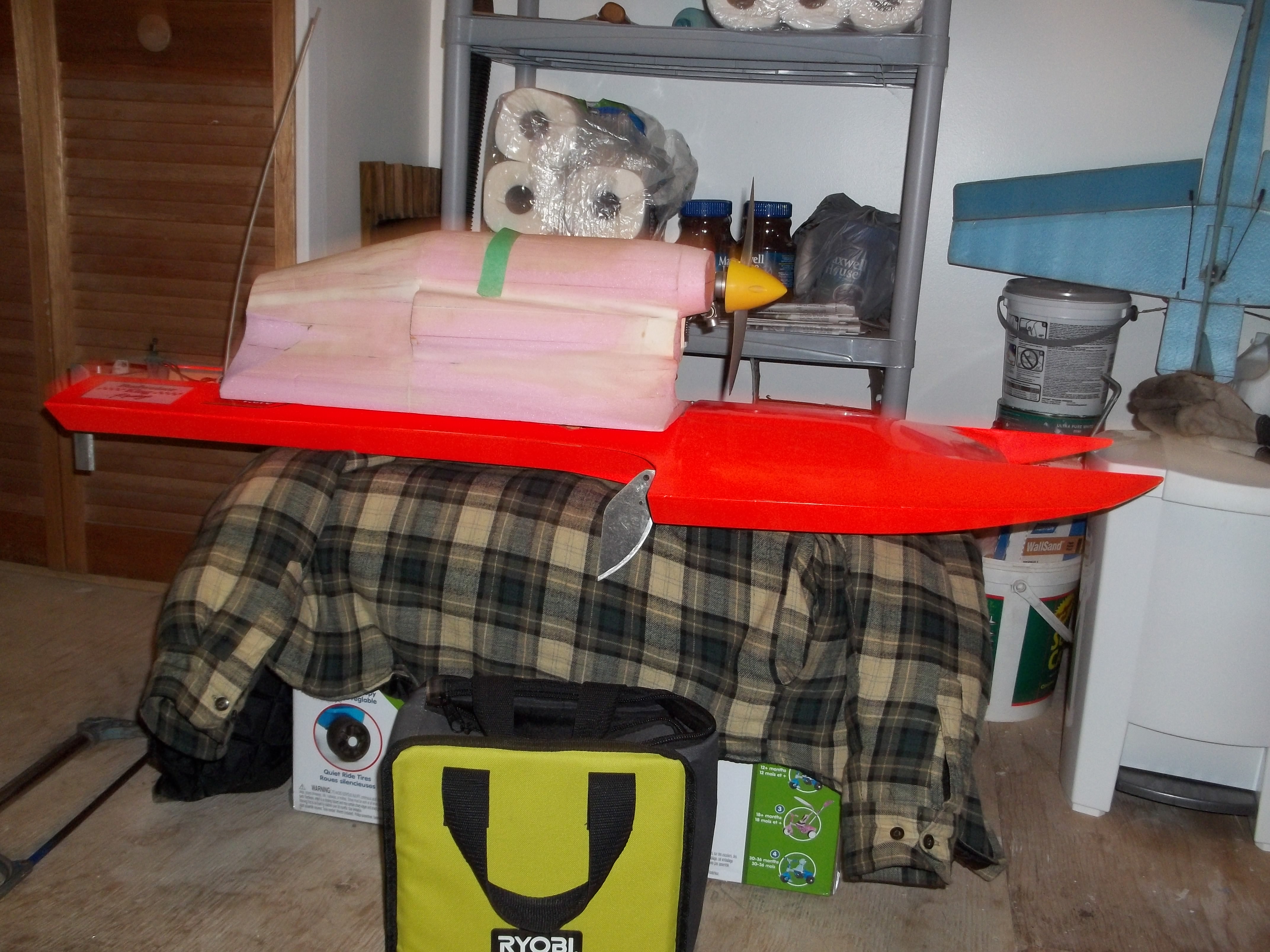

Here is a couple pic's of my own creation, the boat weigh's about 4.5 lbs and as you can see from the pic's I'm trying to create some form of body. Initially in the construction and experimentation of the hull I had to redesign the riding surface of the front sponsons due to a strange duck walking effect, after changing the ride surface angle it went without a hitch as mentioned earlier. I found that the 2 degree up thrust angle of the engine was just enough to lift the hull and still maintain adhesion to the water surface all in all a great successful experiment. Anyone else have a contribution?

For speed applications there is no specific engine placement rule. Many are rear engine because it's generally easier. Some folks prefer pusher prop setups for the more scale type of boat and almost always require rear mounted engines. Other designs such as the Selph Inflicted 3-point hydro use a rear engine/front sponson design and are incredibly fast and stable. The prop thrust on the SI's actually holds the bow down. They're generally set up to be a tad light at the bow for top speed which really is the point of a hydrofoil. Below are my SI3 boats. .20 series SI3 with Jett .35, .60 series with SuperTigre S90K both on tuned mufflers. Also is a picture of my custom built outrigger hydrofoil. The outrigger needs a sponson makeover so it's a shelf queen for now. Hull sizes respectively are 16"wX22"l, 22"wX29"l, 22"wX39"l. The .20 series has gone 49.8mph with a 3" wet rudder. I expect 55-60mph or better with the now 1.625" wet rudder with a 9x6 prop.

Now that is very interesting to see . Keeping us posted is now a net obligation my friend!
