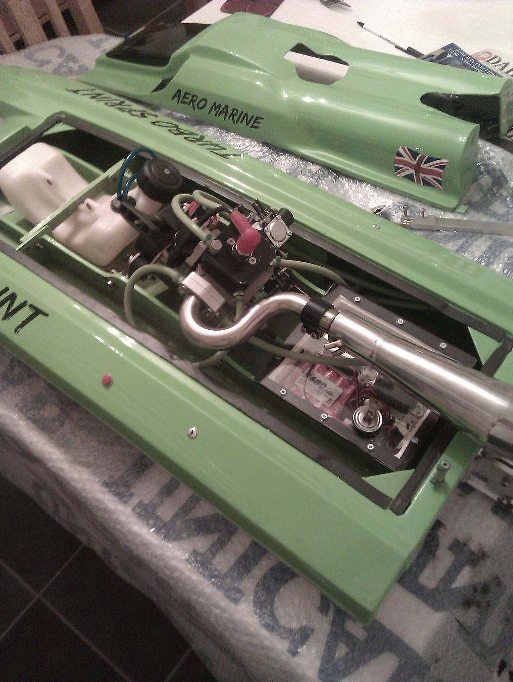

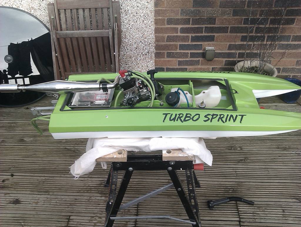

hi im all new to this hobby, before using my boat for the first time i want to be certain the water is circulating properlly and cooling the engine, any tips on doing this? the 2 water pick ups from the rudder are leading to the head, the pipe from the bottom of the head is connecting to the small metal external hole thats on the side of the boat, is this a breather? or for the water thats cooled to engine to pass out from??? theres also one on the other side with a pipe connected to it but its not actually connected to anything? i know i sound like i dont have a clue but im learning slowly ,thanks for your help!

The propwash and/or the water movement forces water up the pipe, through the engine cooling jacket, and onward and outward back to the outside world via the side hole.  Water should be able to flow through the system freely, without leaks.  Normal way to check is to fill the pipe with water to see that it exits the other end, and visually check that there are no leaks to the inside of the boat.  Then when it running on the water, there should be a very visible jet of warm water from the outlet.
