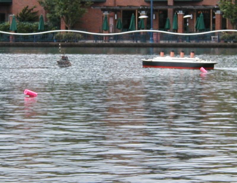

Pool Noodles. Cut off a 6"-10"section, run a dowel through it crosswise, and tie an anchor and line to the dowel. If you keep the string slightly short, they stand up better.
However, use a heavy anchor, or a wave can pick up the bouy and anchor and cause it to move out of place.

I've been using old 100 oz. Tide detergent bottles for a non-race course. Through the handle I run a good length of heavy string with weights on each end, more on the end that I want to hit bottm. I then put a zip tie loosely around the lines below the handle so that in case the buoy gets hits or from the movement of the waves, it will self-adjust.
These I can just toss into the water and will stay in place if I have enough line on them. They have taken hits from boats with no damage to the boats.
If you want to spend the bucks, you can use the marker buoys that are used in water skiing competition.
Third option. Look for a craft store in your area that has styrofoam balls that are used for art or floral decorations.
