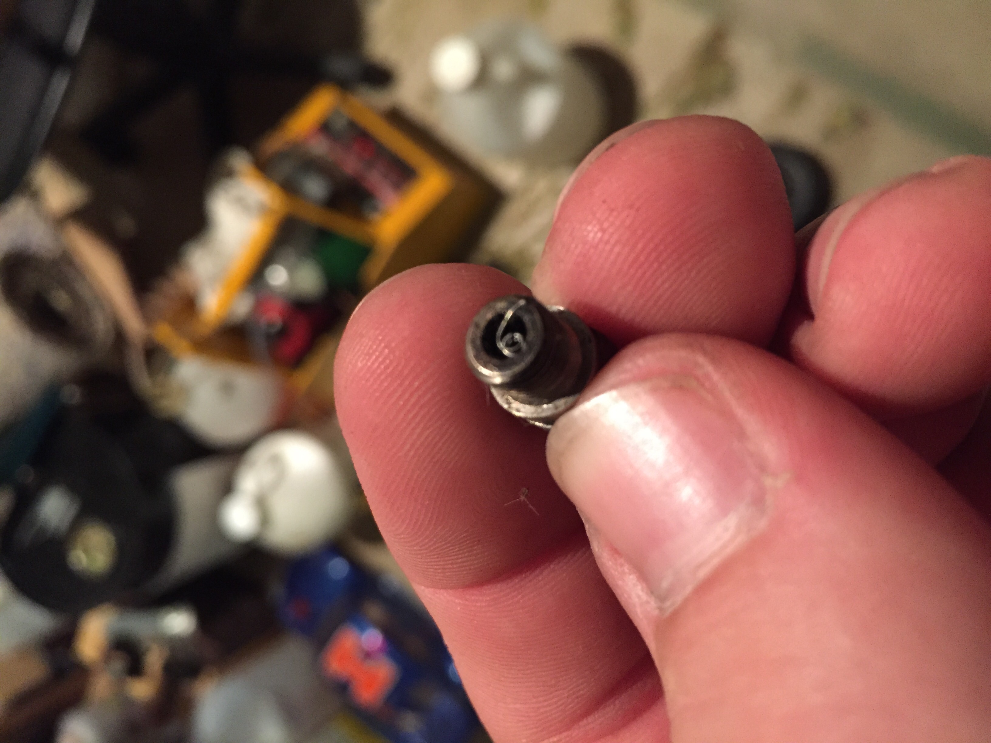

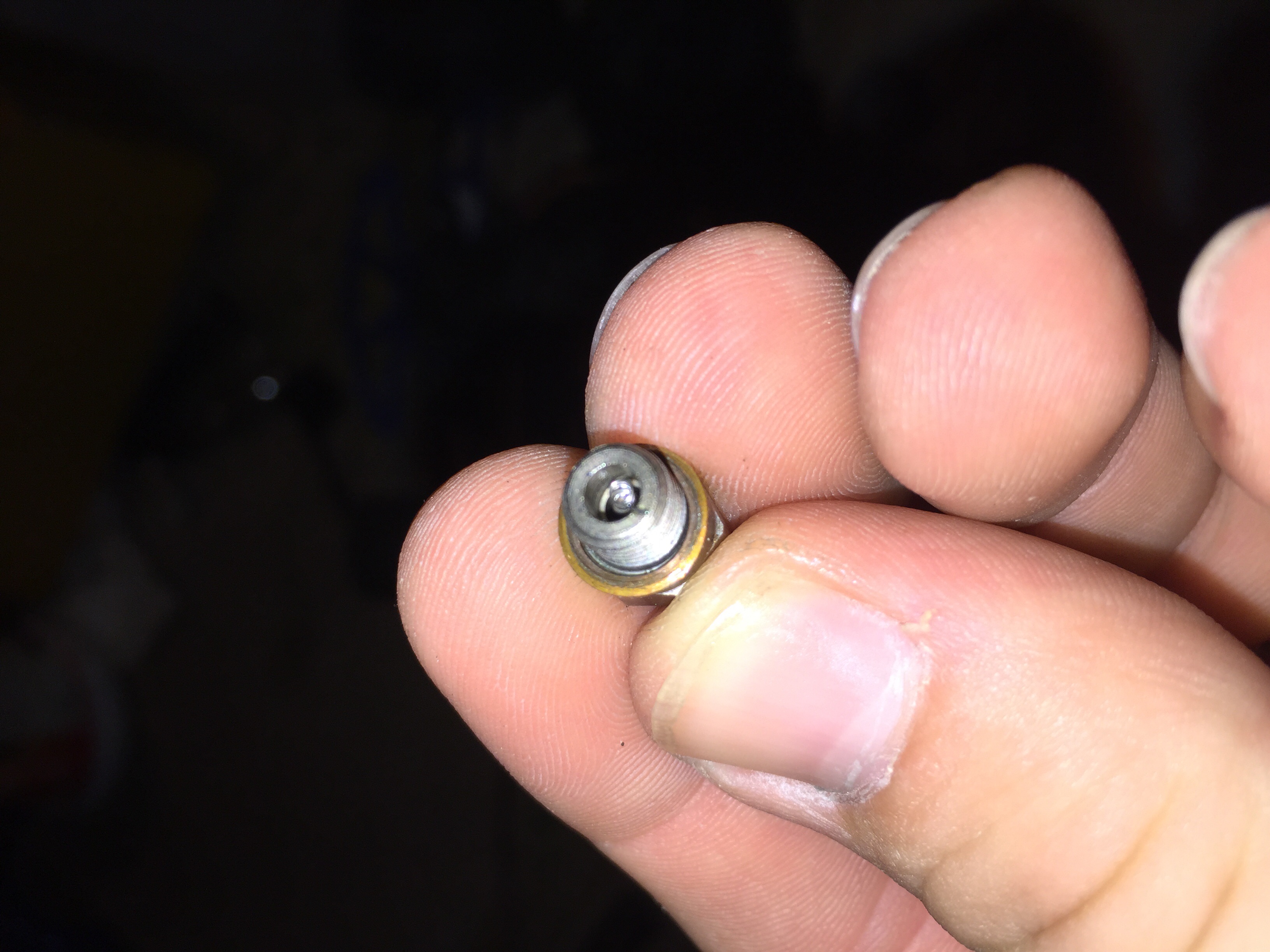

Learning to read your glow plugs will help you learn to tune. Attached (hopefully they upload in the proper order) are several photos of glow plugs. They should appear as "too rich" (bottom of plug looks brand new), "just right" (nice gold color), "too lean" (bottom of plug is black, element may appear fuzzy or have a dull gray appearance), and "WAY too lean" (element crumpled, distorted, or broken element. Bottom of plug black with small pits). A gold color on the plug base and a shiny silver element is good. A slight grayish element and gold plug base means you're at peak mixture. Go no leaner than this setting.

No problem, Ant. I'll take some clearer pictures and repost. The ones I posted are a little fuzzy due to using my phone instead of my digital camera. But one should get a good enough idea from them anyhow. I have a few other plugs somewhere with really crumpled and mushed elements from a lean run. Over-compressed engines will just compress the element usually leaving the element round, just pushed way into the plug cavity. I'll see if I can find those plugs and get some photos of them as well.
