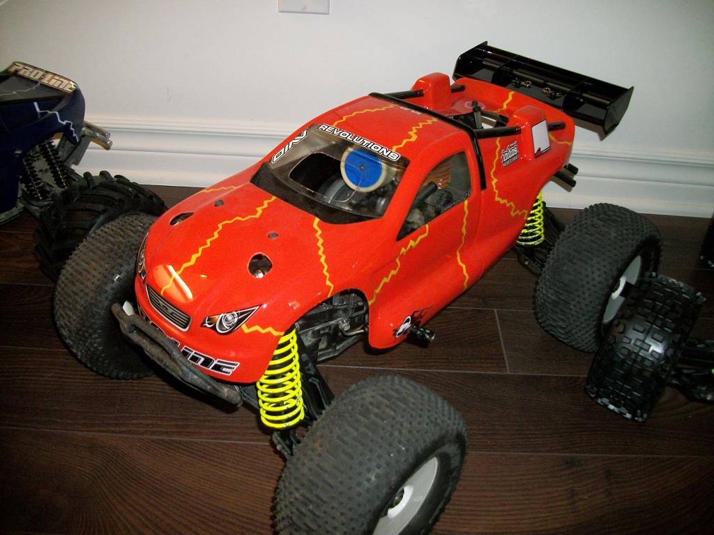

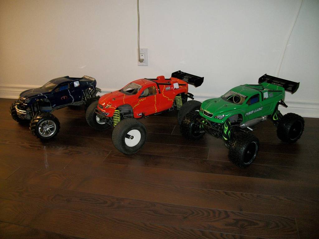

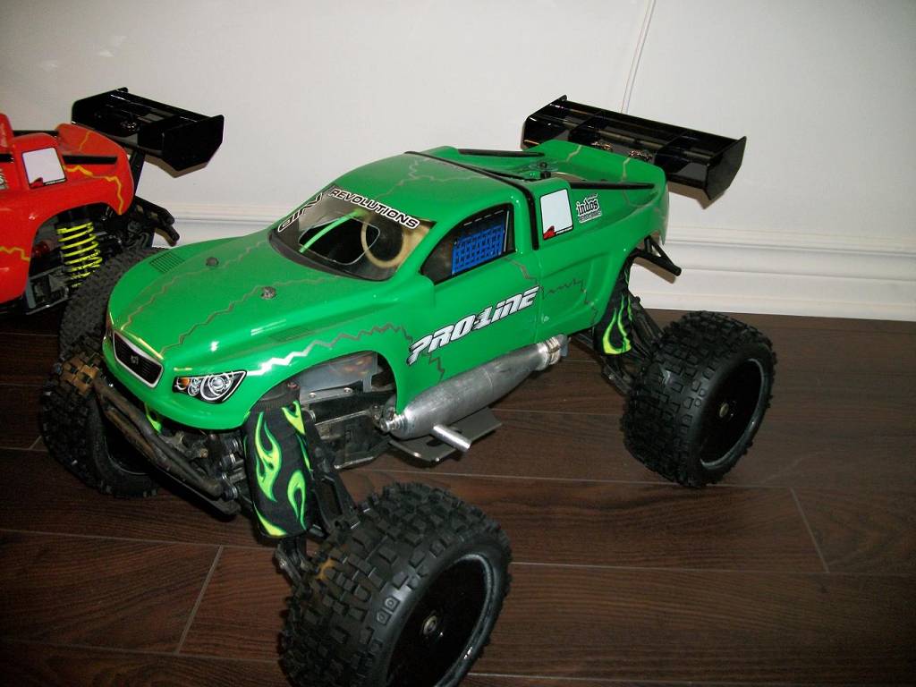

all 3 of my trucks are ready for some action!
but my LST2 and my XXL will have to wait for the summer, im not running nitros in snow anymore.
thats why i bought a waterproof e-maxx.
i did all 3 bodies the same way to have a 'team' lol.

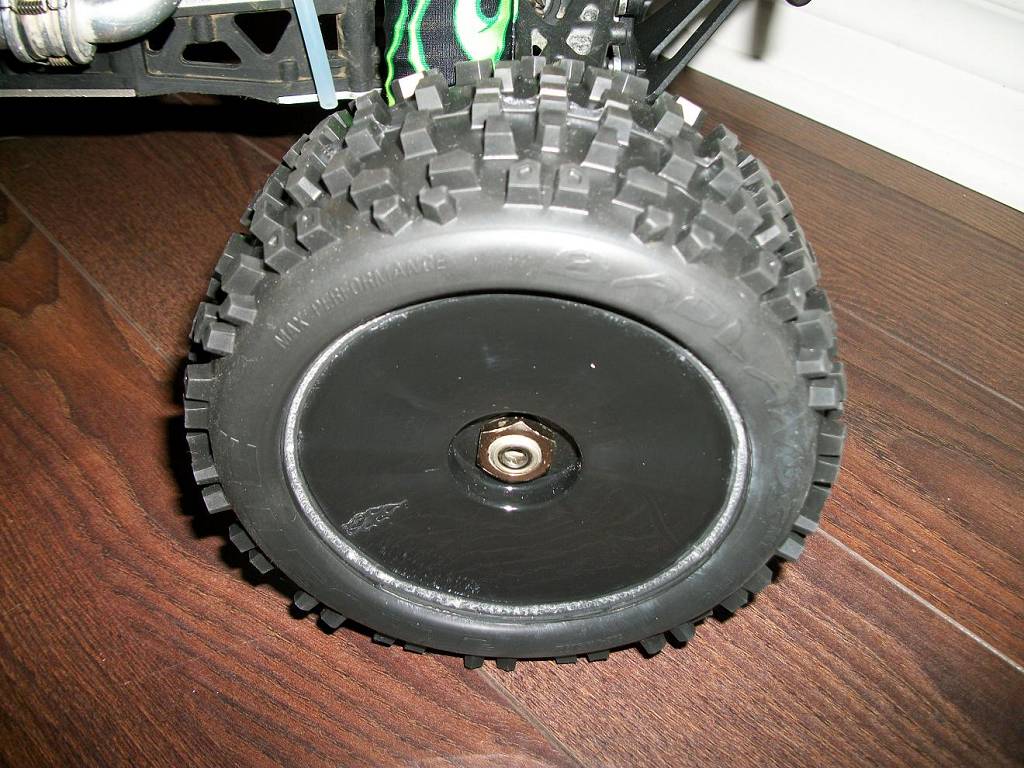

i did some upgrades/replaced parts on some of them, new wings, badlands stretched on lrp wheels, turnbuckle wing mod, exaust gas cooler(will it work!?) front hump pack, new bearings/fuel lines...

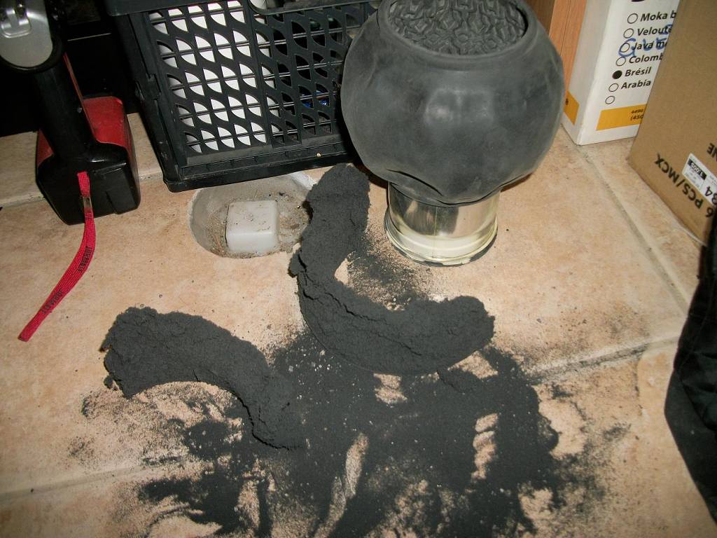

i tried to remove the tires from the rims using the oven method to replace my foams but 2 beads ripped, that was a good reason for buying badlands !(wich i wanted for a long time!)

I see you have found a use for your fuel cooler. Hooked up in your pressure line I see, or is that where it was supposed to go?

thats where its suposed to go (from what they say)
it should cool the exaust gasses so lower the fuel temp, giving a more consistent tune and more run-time since the fuel will be "thicker".

For a fuel/pressure line cooler, you could buy some small copper tubing, coil it up 5 or 6 times in a roll, and plug the original tubing back into each end. The copper allows the heat to suck out and it would be cheap and very effective, just wouldnt look as nice as the one you have
