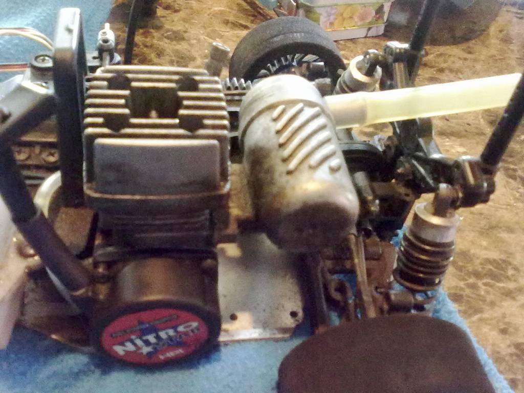

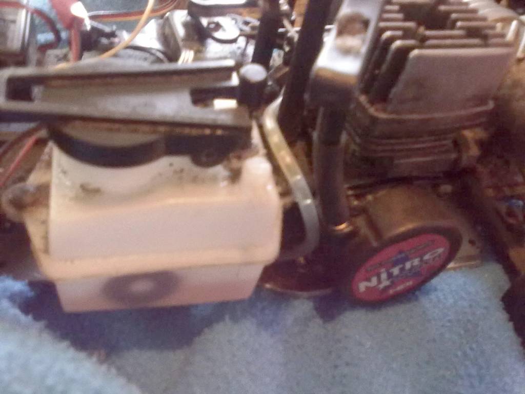

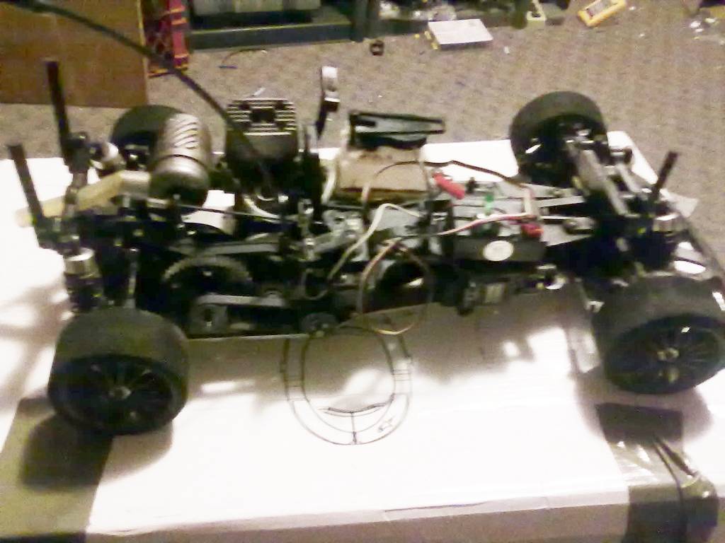

i got this off ebay. $55 shipped.
pretty sure its a HPI sprint nitro(early model, not evo)
has a nitro star .15
this one seems to be missing a bunch of stuff.
the set screw for the brake aint there.
the fuel line between the tank and muffler is missing.
2 screws that should hold part of the spur gear mount arnt there.
im worried there is a second plastic piece to the mount that should be there that is not.
The "AA" battery holder was there, but is all smashed up.
Screw that hold the motor on are nearly stripped.
Motor does have compression....the only good news really.
anyone got info on this model? and exploded view might help me.

Those older HPI engines were tough. I think they were made by Toki? They were an OEM engine supplier for several brands.
Old 10-08-2011 | 08:28 AM
Fractured's Avatar
Joined: Sep 2011
Posts: 107
From: NOR*cal, CA
Default RE: need help on nitro find!
That thing looks rough.  Like it was left outside maybe? Can you take a pic from a little farther back? I used to run a nitro RS4 so I might be able to tell you if that is what it is.
Old 10-08-2011 | 09:10 AM
SyCo_VeNoM's Avatar
Joined: Jul 2007
Posts: 12,987
Received 44 Likes on 41 Posts
From: North West Indiana
Original Nitro RS4
I had one 2 years back ran it a few times till I stripped the spur(which is common from what the one LHS guy I used to talk to told me).
After that I let it sit for a while till I stripped it for parts for other things
http://www.hpiracing.com/instruction...ruct-nitro.htm the manual
Will say that pipe is worth a pretty penny when I was trying to rebuild mine they were going for $30+ alone.
Also it looks like he removed the purple anodizing.

post better pics.
I got one when they first came out and had it for more than 10 years... and it does look like the first gen rs4. (no purble chassis) ...but the 1st gen rs4's came with .12 engines,,,not .15
maybe the put a .15 coil ?
the rs4-2 came with the .15 and a different pipe.

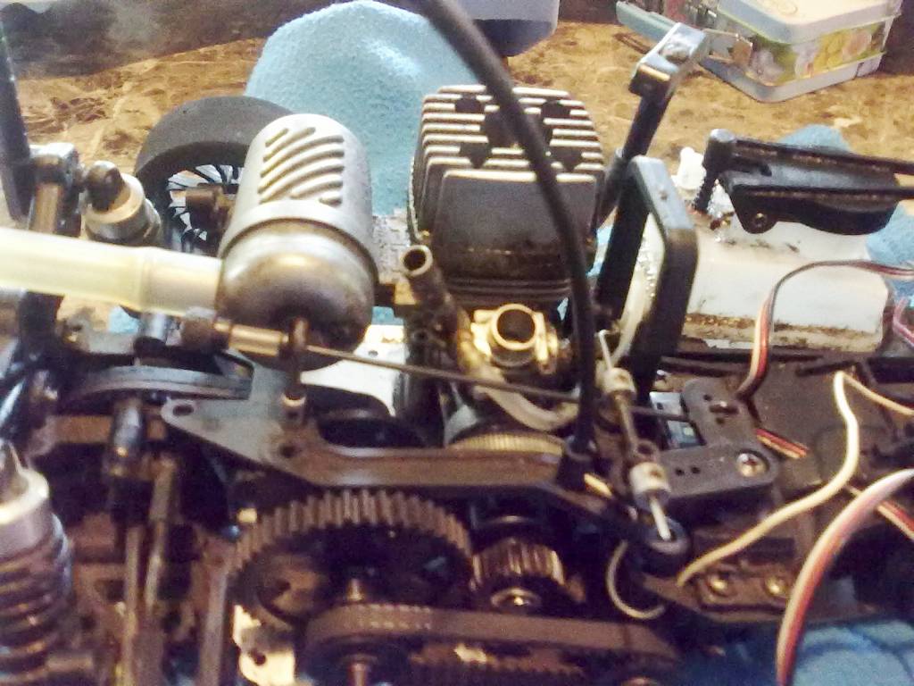

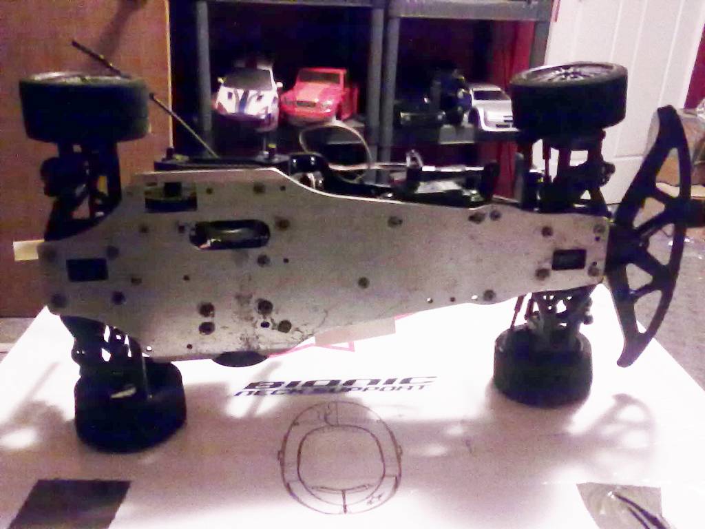

here are some more pics.
maybe its a 1st gen, with a motor upgrade??? Or could it just be a .12 with a newer pull starter on it?
i bought this on a whim, and i have several projects going right now. i may test the motor to see if it will run and then put it up for sale. anyone interested?

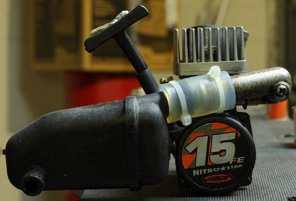

probably is a t-15fe
who knows maybe the guy grabbed any old engine laying around, and flung it on, or upgraded for speed back when they sold the t-15fe still.
lets face it how many people run engines other than stock on their RC's

anyway, that looks like a first gen rs4 with a .12 and a .15 pull starter. even that rear exit pipe came on the .12 engines> http://archive.hpiracing.com/?page=k...ritage/n-m.htm

1996 when they came out. http://archive.hpiracing.com/?page=k...ritage/n-m.htm
hard to get parts but u can still find them on ebay and a few from tower. I bought about $100 on spare belts, for my rs4-2. If you are going to run it on the street,.... get spare belts, buy as many as u can.

I have good news and bad news.
bad news: Rx is dead.
and worse, the clutch bell doesnt seem right at all. it wont mesh right with the spur(doenst even seem to be same pitch?)
and its coming off(away from motor, revealing the clutch shoes)
so until those items are fixed, it wont be drivable. I did manage to get the motor mount screws loose without totally stripping them. this allowed me to put screws in the spur gear mount.
here are pics:
I did test the motor. SHES A RUNNER! Started up really easy. see the short vid. I didnt tune it or anything, just add fuel-prime and start!

Oooh, nice, motor works. Order an air filter before you drive it any, you don't want dust and dirt getting sucked in there. Also it didn't sound like it was that badly out of tune, a slight adjustment on the idle screw and HSN(There isn't an LSN on that carb AFAIK) should have it purring wonderfully.

Heh, yeah, some don't. It's one of the reasons the 15FE is a weak little thing. I remember back in the day one of the biggest hopups for anything sporting one on a budget was the purchase of a proper carb with an LSN, woke the engine up quite nicely.
. when i pull the motor off the chassis to install the new bell i see if i can clean it up and make it look good again.
Don't worry about making it look pretty. Just clean it so it won't bake in it's own filth. Looking pretty is for shelf queens and eBay listings, when you're running it you can't see the engine for the shell anyway.
