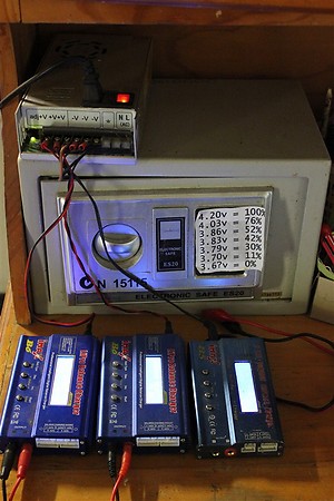

I actually use a 47A server power supply that I got off ebay for $20 to run 2-3 chargers at once as the power supply I got I estimate I could run 6-7 6A chargers at once if I ever felt like it
I found standard PC power supplies didn't give the oomph to run one even as the rails didn't have enough current.

Just so you know most PSU's only put out 3 amps on the 12V rails (and that is it you combine em all) maybe a 600watt one might do 5-6amps but I wouldn't count on it.
Also note you will need some resistors to act as a load to make the power supply stay on as its not a simple switch on newer ones (by newer I mean post 1997). Why I went with a server supply it only outputs 12 volts, and was made to run multiple servers.

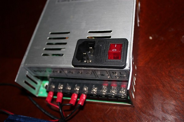

If u don't end up getting the xbox power supply, I recommend getting one of eBay like the others suggested.
Here is mine... Its a 12v 30a LED array power supply and was only $30, then add $7 for the fused power plug fitting and switch... I just cut a hole in the top for the power plug fitting and wired it up....

As for how many chargers you can run on it. That will depend if you charge at say 2 amps you should be able to run 2
if you go full blast at 10 amps you can run 1 (remember the chargers require some overhead themselves)

All done! I ordered the car, battery, and charger last night with 2 day shipping, so they should get here tomorrow or the next day
Here is my DIY PSU:
