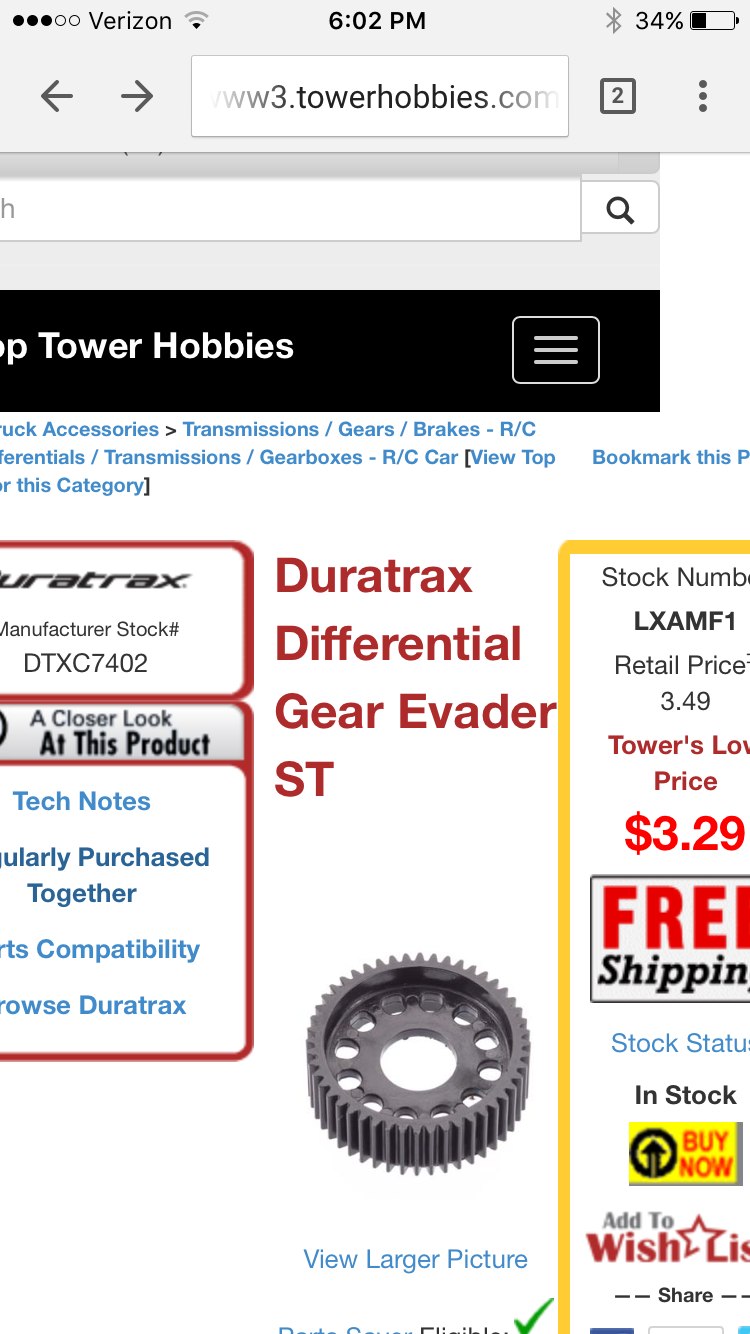

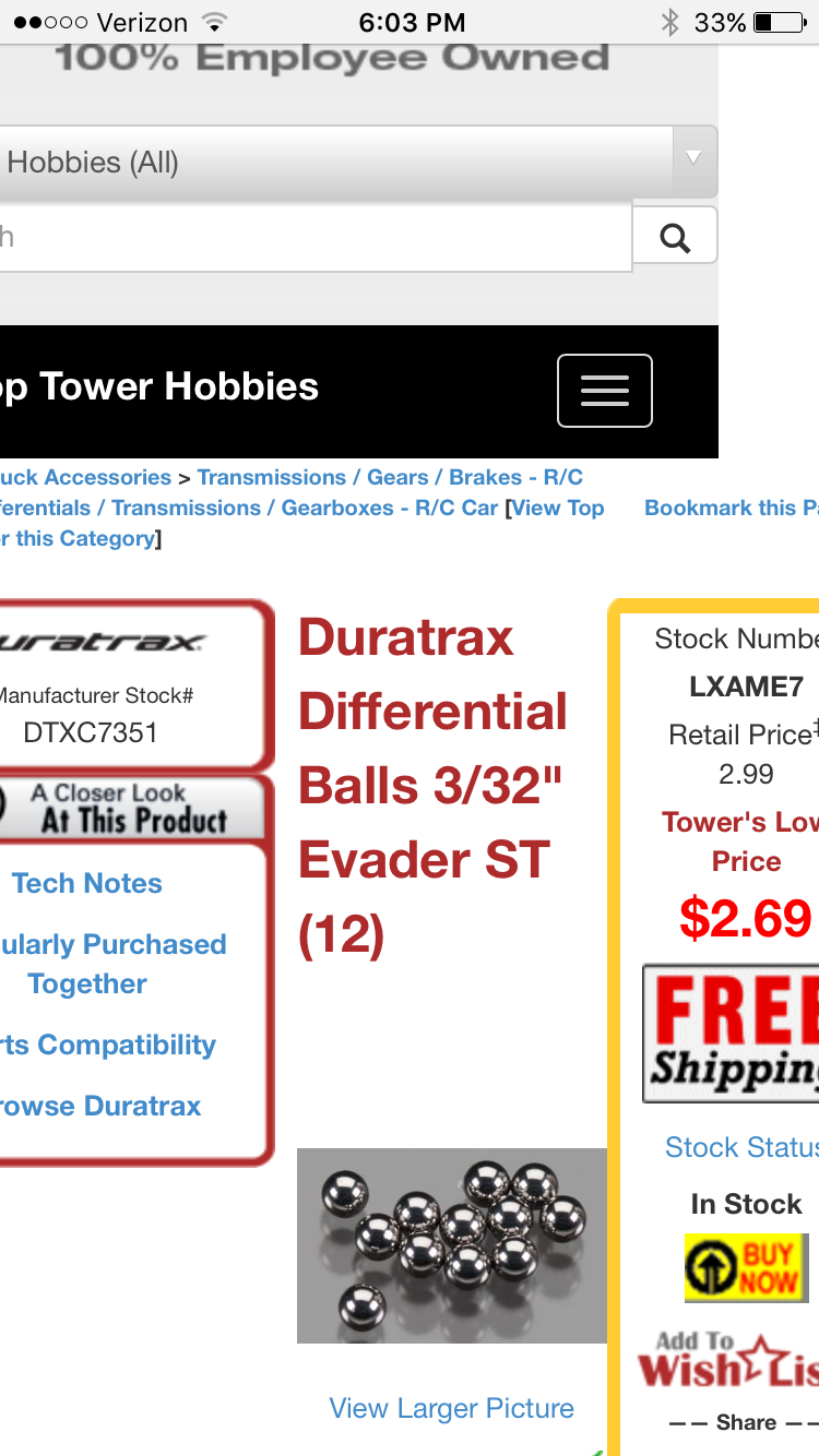

Okay I have to rebuild the differential gear on the st and I had to order the gear and the bearings because the whole assembly is discontinued and I was wondering if there was another bearing that goes in with it (a 5x8)? I ordered these any help please, thank you

5x8mm bearings are not used with the diff gear...5x9mm bearings are used.
Other bearings used in gearbox?
(4) 5x10mm bearings
(2) 12x18mm bearings
(2) 5x9mm bearings
(1) Thrust bearing
The diff gear you pictured rides on the 5x9mm bearings.
