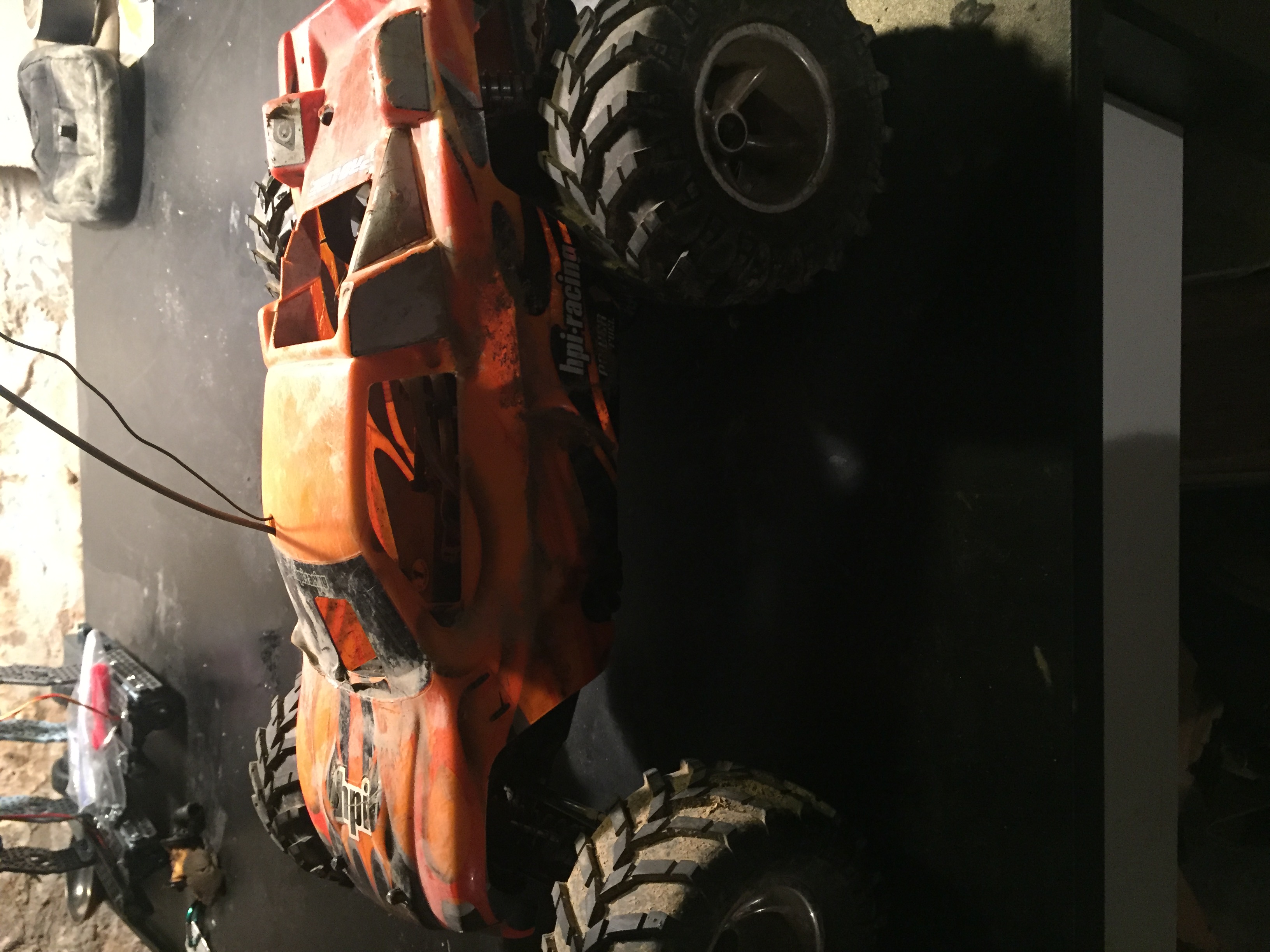

I was given an RC and it needs some work. It needs cleaned up, and some new parts. I have no idea what model it is and all I know is that I believe it's an hpi. Are there any identifiable numbers any where on the frame? I am completely new to this hobby and any help identifying the model so I can find an owner's manual, order some new parts and get it running would be greatly appreciated. Thank you

HPI Nitro RS4 MT2, nice truck! Hope the motor isn't gummed up yet, it looks like its been sitting for a while.

Collector is wrong, no other way to say it. This is a HPI Firestorm, not a MT2. Owners manual, exploded views, and parts list are available online in pdf form from HPI.
Btw acetone works great dissolving old nitro gum, but it might dissolve the foam air cleaner too. If the engine is gummy just pour some down the carb and threw the glow plug. Let it sit on one side for a few hours, turn the crank a little, let it sit on the other side. Pop the carb off and let it soak in a cup of acetone. Then just turn the crank with it upside down, glow plug out a few times. Then run it or spray some wd40 in it if it's going to sit for awhile before running. If you can help it you're better off not taking the engine apart anymore than this, the possibility of creating more headaches for yourself increases the more you take the engine apart unless you're going to seal it all up with rtv
