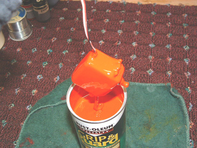

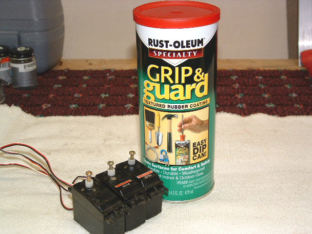

Or in the plastic dip..............great product

is that removeable????

Yes indeed this product is removable. Simple razor blade with do the trick. After I apply the second coat and trim the servo horn I'll post a close up for ya. Gonna be a couple days though for it to fully cure.

Did you put anything on the servo to keep the stuff from getting into the servo? I would really like to know how it turns out.

Big I just scuffed the servo housing so the dip would adhere better and as far as the top I plan to visit LHS for some o-rings to seat to the top other than that the other conjoining housings have o-rings in them.

Second coat was applied 1 day ago. I dont think there is going to be any problems with this

Finished product:

have you tested it out yet? did you have any problems?
Old 11-06-2003 | 11:53 PM
Joined: Jul 2003
Posts: 77
From: BFE, IL
Default RE: Proof is in the Puddin............
yes I benched tested them out before they even were installed in the truck work excellent, nice smooth operation as before.
