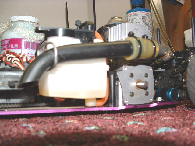

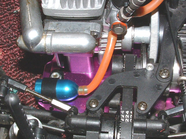

Old 10-30-2003 | 08:00 PM
Joined: Jul 2003
Posts: 77
From: BFE, IL
Default RE: Boost Bottle Kit
ORIGINAL: GALAXY
NitroNostrils...what straight pipes are you talking about? sounds interesting
Here's acouple of pics: one is of the boost bottle, I hooked it up to the carb works fine with the second picture.... ENJOY!!
ID:	71277   Click image for larger version

Nitroaddict I'm not trying to defend nor hype it up. Its was a simple purchase to see if the thing worked or not. As far as drilling into the carb I didnt go that route, I used the supplied nipple fitting with the kit and removed one of the carb screws and installed the fitting in place of it. Once installed I fired it up and zoomed around the PL I did notice a good throttle response, but nothing to have a orgasm over. I mainly bought this to run the straight pipes (to bug the hell outta the neighbors). Its great for the basher who like to tinker around with different products.
