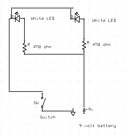

hey jr, lets see that wiring diagram im interested in making my own!.. i can even see a plexi glass underbody tube, shat even i could make a plexi glass chassis that glows! Oh man look what you did now, if this turns into another project [>:][>:]!!!

Anyways, heres a (badly drawn LOL) schematic.

I tried this on my mt2 with pretty good results... If you follow jakjr diagram you shouldn't have any problems... If you want to see in the dark.. Get the brightest led lights from radio shack that you can.. I did this and yes you can drive in the dark... You must get the reflectors for this to work... range of about 5-6 feet... good for parking lot not woods..... I also got the blinking led tail lights.. they look great... As for your question about heat... Not an issue at all....and the 9v batterty has lasted all summer so far....

Alos, you can make LED's brighter by reducing the resistance of the resistor used with one, for instance 470ohm is the standard resistance used with an LED, but if you go down to say 220ohm the LED will be a bit brighter, dont go down too far though as it will eventually burn up the LED.
