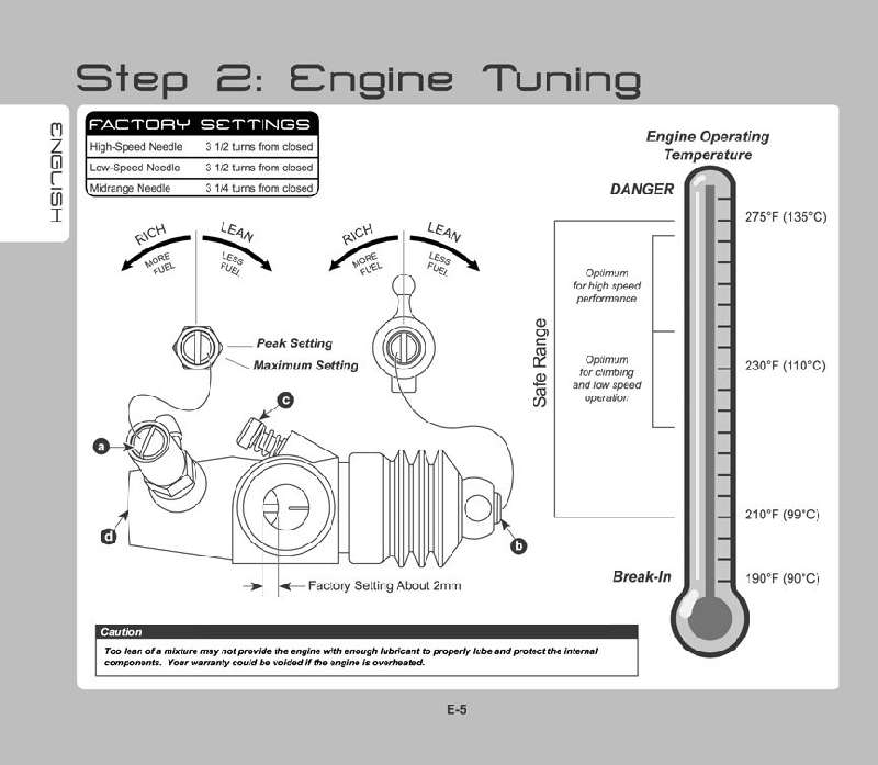

Hey everyone, I have a Savage 25 with the 21 3 needle carb. I can't get the truck to idle and I was wondering if anyone knew where I could begin to tune it. I already tried the factory settings but they are for the 21 so it doesn't work. Also, I know its not the glow plug and anything else. Thanks for any help.

Which ones are which?
A)?
B)?
C)?
D)?
Old 01-30-2005 | 12:58 AM
scale only 4 me's Avatar
My Feedback: (158)
Posts: 10,420
Received 54 Likes on 52 Posts
From: Avon Lake, OH
Default RE: 3 Needle
A) HSN aka High speed neddle
B) LSN aka Low speed needle
C) Throttle stop screw , this sets the air gap so the it doesn't get completely cut off when you apply brakes, it should be set .5mm minimum to 1mm max open while holding full brakes,(they say 2mm,but that sounds like alot to me) take the air filter off and get it adjusted before you do anything else, Do not adjust it while holding the brake on!! you can damage the screw and or the barrel
D) Leave it alone,, should be set flush,,Some people call it the midrange needle but it's really just sets the splash bar position,,leave it flush with the brass case,, If you move it you'll have to move the LSN also
Good luck

When I adjust the idle speed screw it seems to being doing nothing to adjust the carb opening. It always returns to the same spot and when I tighten the screw some more it gets really tight and the carb cannot move anymore so I have to loosen it again.
Old 01-31-2005 | 10:08 AM
My Feedback: (158)
Posts: 10,420
From: Avon Lake, OH
Didn't you see this above
You need to hold he throttle open a little as you make you adjustments

I think B is your Mid Range Set screw and D is the Low End Setting.
BTW, is your fuel filter clean? And did you change your plug to check it?
Old 02-11-2005 | 10:47 PM
My Feedback: (158)
Posts: 10,420
From: Avon Lake, OH
ORIGINAL: B.T.D.T.
Sorry, Bud you're wrong
Another example of a typical 3 needle carb
http://www.ofna.com/pdf/eng-hyper21.pdf

I stand corrected. Don't read when your sick. Last night I was reading the article from RC Car Action April 2004 Piston Power Fact & Fiction 3-Needle Carbs. It shows details of the carb.
Now I was looking thru an LST Manual online and saw in the carb section that I was wrong in the carb needles. I went back to re-read the article and I stand corrected. So I am retracting my earlier posting. Sorry if I confused you.
