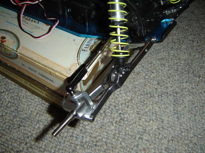

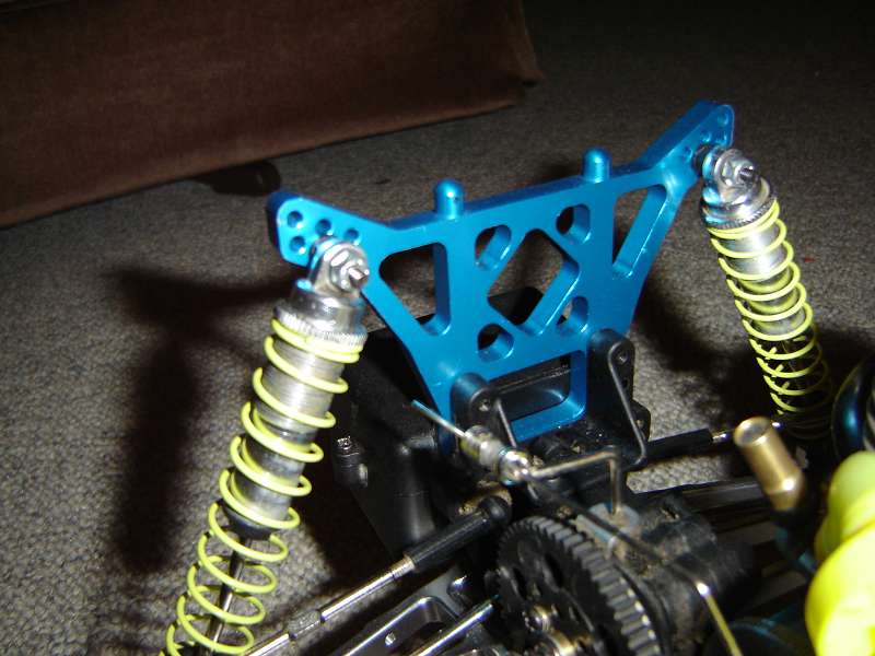

Thanks everyone. I really like Amsterdamn's evader, that what I want mine to look like eventually. Right know I have aluminium Front and rear suspension arms, rear shock tower (what I want to take the anodizing off of), Rear hubs, front knuckle arms and front hub carriers. I eventually want to get aluminium front and rear bulkheads, front suspension tower and engine mount. Also I have a duratrax kwik-pit super start on order from tower hobbies along with:
-These Wheels http://www2.towerhobbies.com/cgi-bin...8&I=LXRD73&P=K
-These Tires http://www2.towerhobbies.com/cgi-bin...8&I=LXECG5&P=K
-These Tires http://www2.towerhobbies.com/cgi-bin...8&I=LXFHL7&P=K
Oh yeah and I almost forgot I read in an old RC driver how to remove anodizing with either ez-off or Drano crystals and there was Pics and the parts looked great, have any of you ever tried this method?
Here are some Pics of my evader with its current mods.
