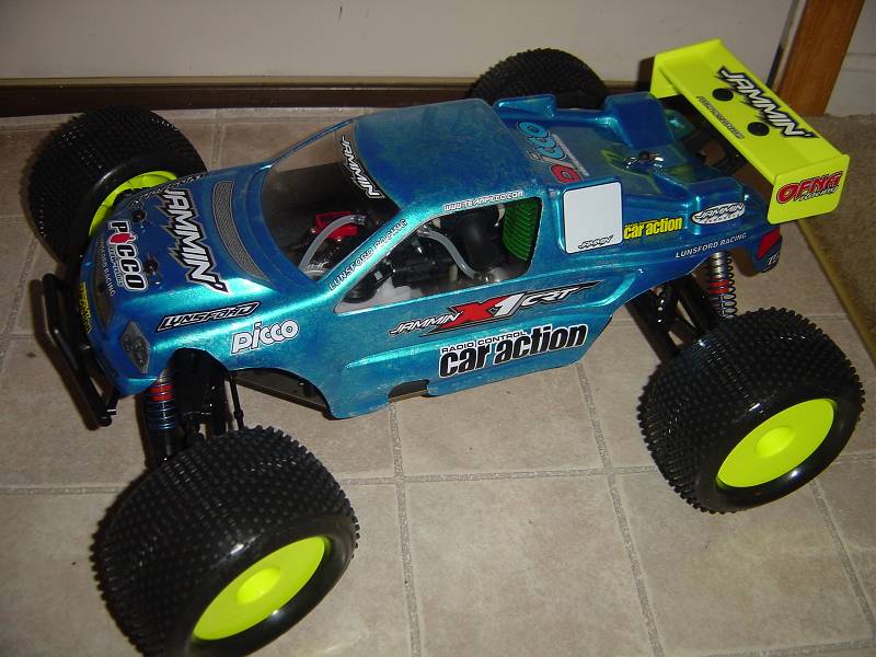

Does anyone know if there is something you can put between a body and exaust to keep it from being burnt? I have recently built a Jammin CRT and my stock body touches the exaust.

put heat proff tape on the inside of the body areas u dnt want burnt

or cut the body a little bit wider around the exaust.

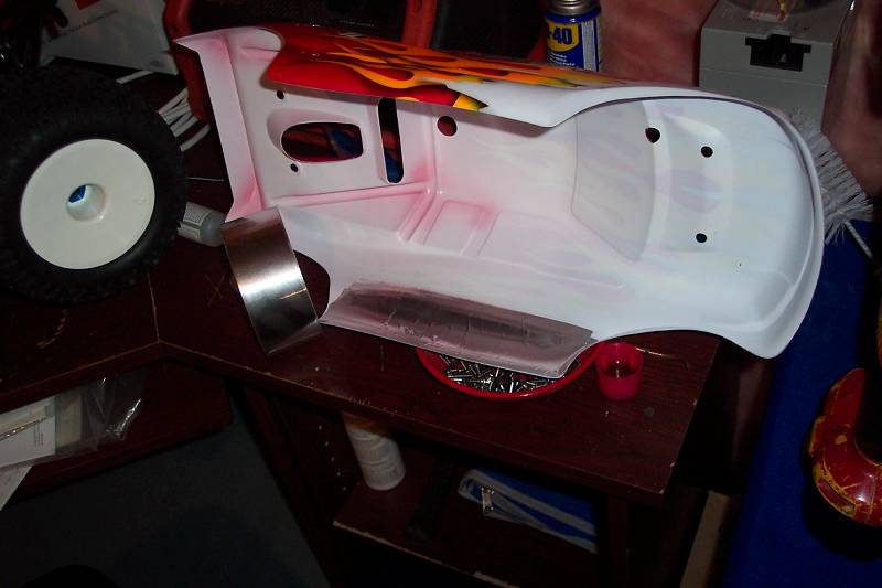

I use that Foil Tape for wrapping Pipes and it works,Plus you can get it at most hardwear stores...
