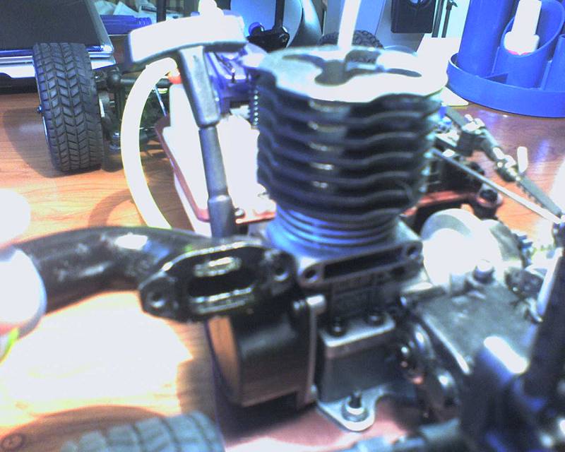

Hi,
I have enclosed a picture of my Cen NT-16 with a manifold I have. It can bolt onto the engine without a problem, but it is a differnt shape, and also the exhaust exit on the engine is a different size to that on the manifold as you can see..
Will it still work fine:

It'll work as long as there is a good seal between the two, but you'll get much more power if the manifold matches up the opening on the case properly. You could try dremelling it to shape (i've done that do make minor mods on my manifold) or just buy another manifold which matches up better - it'll probably only cost a few quid.

It's all to do with air flow - if you prevent spent fuel, oil and gas getting out of the combustion chamber you're robbing the engine of power.

You don't need a NT-16 manifold & gasket - most side exhaust engines use the same exhaust size. Just seems like you were unlucky with the manifold you've got. Take the engine into model shop and they'll probably be able to find a manifold which will match the engine...

You would definately be better off with a matching header. like snow said, it has to do with the airflow. You want a nice laminar flow through your exhaust pipe, and the little bit of mismatch there would be enough to cause it to be turbulent.

Looking at the photo, the height of the opening of the manifold looks bigger than the exhaust opening of the engine, I dont think this will seal properly. If I am wrong, then the dremeling I would also recomend to widen the header opening to match the engine's exhaust opening. I think most headers opening does not exactly match the exhaust opening, its usually smaller, except on rear exhaust with round ports. This is the easiest mod done with nitro engines which gives it a little more power because the air is not restricted.

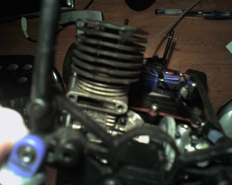

Hey, sorry for the bad quality photos, but you can see below what I mean by where the fumes come out is actually smaller then the engine outlet. You can see on the right side of the engine in picture 2, that the inside of the outle is at an agle which feeds into the piston.

If the pipe seals properly and there are no leaks you will not have the performance from that setup that you could have. It is the same as porting and polishing heads on real to life size cars, it helps the exhaust escape smoothly thus causing a vacuum effect to allow more out faster. The faster you can get ALL the exhaust out of the enging the faster it can get more in and start over again. It has to get in fast and out fast in order to have the best performance. If you are not looking for the best performance then you may not notice a difference.

If you use that header, the car will run, but you will not see the same power or RPM's as you would if you had a matching header.
Like Dudelive said, it's how fast your exhaust gas flow rate is that dictates your intake rate. Haveing the headers not matching will slow the exhaust gas down considerably.
