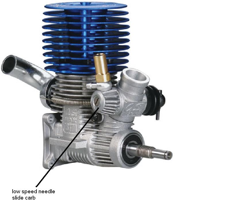

Old 12-18-2006 | 12:15 AM
turbotb0205's Avatar
My Feedback: (31)
Joined: Jul 2005
Posts: 1,059
From: moundsville, WV
Default RE: Why Engine keep cutting out?
the low speed needle is usually located in the throttle arm the screw in the center if you have a rotary style carb. "rotates to open" to set this properly do the pinch test
pinch the fuel line if the engine idles up for 3-4 seconds then dies.. the needle is set correctly
if it dies out almost imediately then its too lean richen it "counterclockwise"
if it revs way up for longer than 5 seconds its too rich lean it out "clockwise
all of these adjustments will be made to the low speed needle

Ok thanks,that first picture is a bit blured,is that a nut there or a screw,mine is a nut not a screw like the idling screw.Also if i pull the throttle linkage,my nut for the Lsn MOVES ALSO,IS THIS NORMAL?THANKS.

I did some research on the buggy you have and apparently the engine in it (.15xcp) only has 1 needle a HSN or main needle to make any mixture adjustments. This high speed needle points straight up from the carb, you cant miss it. That nut you are talking about I think just holds the the throttle linkage onto the slide carb, I tried findin pics of it online but there are not many good ones to look at.
