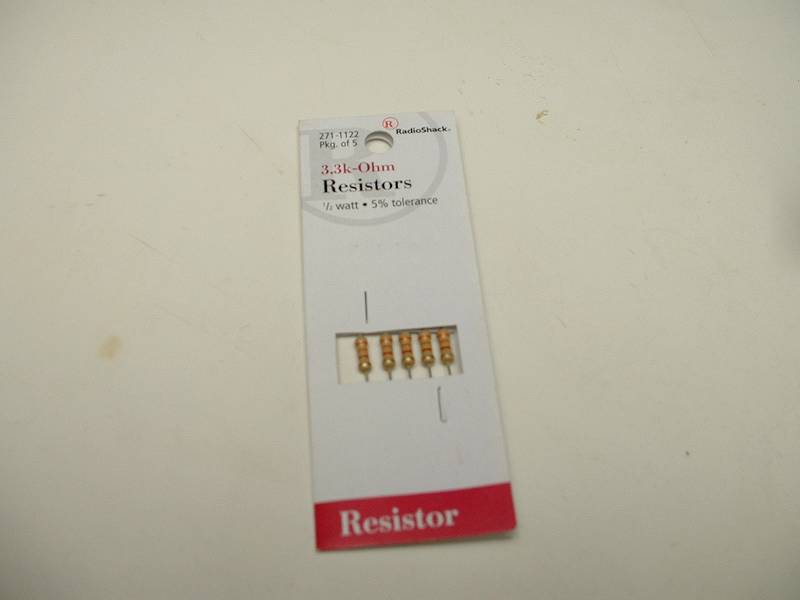

Old 06-22-2007 | 06:17 PM
Nick2618's Avatar
Joined: Mar 2007
Posts: 3,671
From: Sarasota, FL
Default RE: LED Lights?
would these work?
Old 06-22-2007 | 06:38 PM
Nick2618's Avatar
Joined: Mar 2007
Posts: 3,671
From: Sarasota, FL
Also i only need to use the resiators on the + right?
And what do i need for a 12v light? with 120 vac
Old 06-22-2007 | 08:39 PM
mattnin's Avatar
Joined: Jan 2006
Posts: 834
From: grand junction, CO
For the 120VAC you are going to need an AC to 12V DC converter
