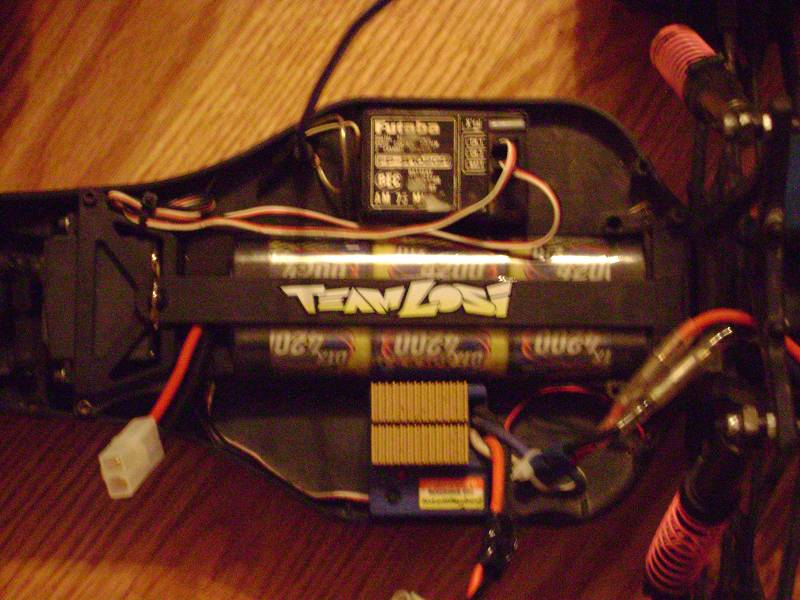

ok i am having a small problem , i have a 7.2 v xxx-t when i am running it i can hear that the motor is getting power and then no power and then power and so on and so on BUT i never take my finger off the trigger ? i checked the antenna connection into the servo and that was fine ? made sure all my connections are fine . what else can i check ? it happends when the car is a little bit down the street ? maybe at like my neighbors house but i thought they would get a better range than that ? CAN ANYBODY HELP? THANKS IN ADVANCE !

are the motor and battery wires far enough away from the reciever/antenna? that'll shorten the range sometimes.

this is what im working with

is that electrical tape around the battery lead off the esc? sorry the photo's a little dark

Is the chassis made of metal or plastic? The reason I ask is because it looks like the antenna wire is touching the frame. That could definitely be the problem if the frame/chassis is made of metal.
How far away are you going before it starts breaking up?

It's a xxx-t chassis so it's plastic. Look for frays in the wires. You should be able to get a couple hundred feet range, no problem. If it only happens when you are at a certain distance then you have a radio issue.

yes it is tape around the esc battery wires someone before me had cut them for some reason ? maybe for a new connector?
the radio batteries read more that half on the display ?
the frame is plastic . it is getting about to the far side of my neighbors house .
Yes it is a brushed motor i will also have to look at that .

well if im in my driveway where i usually am the neighbors is like 50 yards but my brothers will go much farther i have to turn around way before his or else i will have to walk closer to my car because the range is to far? not sure how long it sat i just bought it from someone else. the reecier looks old ? not sure though

Since everything else looks fine I'd then try soldering some new capacitors to the motor. I've had a few times where I was pulling my hair out trying to figure out why my radio was glitching and it was due to the lack of caps on the motor. The motor creates radio noise and the caps suppress it. I'm not sure what caps you'll need, usually the ESC manufacturer will recommend which ones to use. If not I'm sure somebody here can come up with what they've used.
