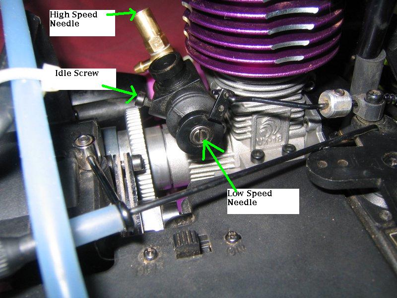

Engine Tuning and Troubleshooting
It's a fact of nitro life: sooner or later, your engine won't want to start or stay running long enough for you to get up on the drivers' stand. Don't shelve your piston-pounder and start charging batteries just yet hard-starting woes aren't usually tough to fix. Follow these steps, and you'll reach nitro nirvana again in no time.
Got pinch?
Before we start troubleshooting, let's first make sure the piston and sleeve aren't toast. Remove the engine's glow plug, and rotate the flywheel with your finger. As the piston reaches top dead center, you should at least feel resistance as the piston is “pinched” by the sleeve. This tight fit seals the combustion chamber and is critical to engine performance. If you don't feel any pinch, you probably need to replace your piston and sleeve.
Check out the glow system
Even rank novices know to check out the glow plug when starting problems occur, but few remember to check the other half of the glow system—glow starter! Make sure that your glow starter is fully charged (or has a fresh battery), and its contacts are clean. Press the glow plug into the glow starter and watch the coil it should almost instantly glow bright orange, and the entire coil should glow. If the coil glows dull red, or it doesn't glow at all (and you're certain the glow starter is charged and making good contact), you need a new plug.
If you have an electric starting system, the testing procedure is the same, but you must remember to touch the glow plug to the heat-sink head as you crank the engine if you don't, the glow plug won't light because the circuit is incomplete.
Do the tighten-up
Make sure that the engine's heat-sink head and backplate screws are fully tightened. Cinch them down in the pattern shown to ensure even tightness if you torque the screws down completely one at a time, you'll warp the parts and prevent them from sealing properly against the engine. Pull-start engines require the starter housing to be removed for backplate access be careful not to uncoil the starter spring in the process! Slip a screwdriver between the backplate and housing to prevent the spring from popping out, then tape or rubber-band the assembly after removal so it doesn't go “boing!” on your bench.
Speaking of sealing...
While you’re wrenching, take a look at the gaskets or O-rings that seal the carburetor base and backplate. If they’re damaged, replace them. A coat of Permatex Ultra Copper sealant (or similar sensor-safe automotive sealant) is also good insurance against air leaks.
Know your limits
If your engine seems to start easily enough but shuts down as soon as you let off the gas, check your idle-limit screw—the little guy just in front of the carburetor opening. Turn the screw so the carb still has a 1mm (or so) opening when full brake is applied. If the screw turns very easily, put a drop of thread-lock on it to prevent engine vibration from causing the setting to drift.
Needle needs
If you went nuts with your carb’s needle settings before your starting troubles began, you should reset them to factory specs. Lost your manual? For most engines, a good starting setup is “flush” for the low-end needle (adjust the needle so its screw head is level with the opening in the carb body the screw head sits in), and “two turns out” for the high-end needle (gently turn the needle clockwise until it bottoms out, then give it two full counterclockwise turns).
How’s that fuel tubing?
Even tiny pinhole leaks in your vehicle’s fuel and pressure lines can cause erratic engine operation and starting difficulties. When in doubt, replace the fuel tubing it’s inexpensive, and with all the color options available, it’s a cheap and easy way to give the chassis a new look.
Tanks for the memories
Your fuel tank isn't clogged, is it? Look for any crud in the tank where the fuel pickup line is, and get it out of there. Likewise, you should check your vehicle's in-line fuel filter (if so equipped) frequently it can become clogged with debris and impede fuel flow if not cleaned regularly. Finally, consider removing the tank's plunger-type primer, if so equipped such primers are prone to air leaks. After you've removed the primer, fill the hole with a machine-thread screw and some silicone sealant.
Freshen up your fuel
If your jug of fuel spent the winter on the garage floor, it has probably gone bad. Very bad. Dispose of it responsibly, and get yourself a new gallon. Store it in a cool, dry place away from sunlight and off the floor. If you like to race outside or go on extended-play missions outdoors, try to keep your fuel out of the sun and heat. Trinity's Nitro Kooler bags are the best way to prevent solar heating and protect fuel in clear containers from light exposure.
Now that you've ironed out any potential problems, you're ready for a first-pull startup. Here's how to make it happen:
1. Prime the carburetor. Remove the pressure line from the exhaust pipe, and blow into it you'll see a solid jet of fuel fill the fuel line up to the carburetor. When the fuel hits the carb, stop blowing. Reinstall the pressure line.
2. Install the glow igniter. If it's a cam-lock type, make sure it's secure. Is there a gauge on top? Make sure the needle is in the green.
3. Crack the throttle. Instead of triggering the radio, just turn the throttle-trim knob to open the carb another 1/2 millimeter or so.
4. Pull the starter cord! Give a sharp tug, and your engine should now be running. At the very least, it should pop on the first pull and start on the second or third (the extra tugs are usually only required if the carb wasn't fully primed).

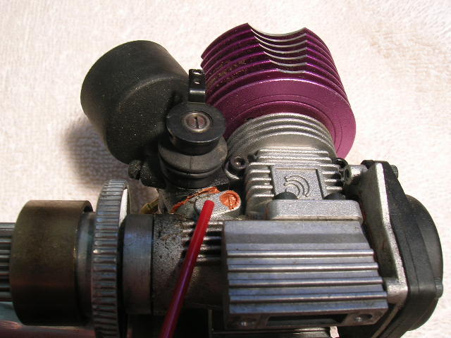

My pet peeve is Airleaks.....Here are some words on the matter.
In order for an engine to idle, transition and tune consistently it must be airtight- airtight meaning that no air can enter the engine except through the carburetor intake. Surprisingly, even brand new out-of-the-box high-end engines can have air leaks and until these leaks are found and eliminated, the engine won't run consistently and cannot be precisely tuned. The good news is, several years ago I figured out an easy way to check for and fix air leaks. You'll need the following:
• A small glass of soapy water
• A small brush
• About a foot of fuel tubing
Step 1. Be sure that the high-speed needle is open at least two turns out and the throttle is at fully open.
Step 2. Install one end of the fuel tubing on the carburetor nipple. You're going to be blowing into the other end of the tubing to pressurize the engine crankcase.
Step 3. Place your thumb over the carburetor intake to prevent air from escaping, then blow into the fuel tubing while brushing soapy water around the base of the carburetor, on both sides of the pinch bolt, around the fuel fittings, at the high and low speed needle valves, around the front bearing and even around the back plate.If any bubbling occurs you've got an air leak. But don't be alarmed. Fixing the leak is easy and your engine will run remarkably better and more consistently when you've eliminated these leaks.
The Fix...
The most common air leaks seem to occur around the pinch bolt. Applying a dab of RTV (or silicon) over both exposed sides of the pinch bolt will fix this type of leak. RTV is also great for sealing any leaks around the base of the carburetor. Simply remove the carburetor and run a small amount of RTV around the base of the carb where the leak occurred. Reinstall the carburetor and allow the RTV to ooze out between the crankcase and the carb body. For leaks around the high-speed needle valve fittings, usually retightening the high-speed needle assembly will take care of these. Leaks directly at the high speed or low speed needle usually means there's a damaged O-ring that must be replaced. Many racers don't realize that the front bearing can leak air. That's why nearly every high-end engine uses a rubber sealed front ball bearing to not only keep out dirt, but also air. If your front bearing leaks air, it's time for a bearing replacement. This simple leak check can easily be done even when the engine is installed in a car. After you've done this test on several engines you'll be surprised of two things: first, how often unwanted air leaks occur and second, how much better your engine runs, idles and tunes when it's airtight. To run right it must be airtight!
Airtight GasTank...

To prevent your engine mount screws from pulling through the chassis aluminum from vibration (first pic), add some large diameter washers under the heads of the screws (second pic). This spreads the stress over a larger area. I used zinc plated washers from McMaster Carr item # 91100A120 3.2mm ID 9mm OD $1.07 for 100 (plus shipping). You could use a bigger washer and grind the edges if necessary to get them to fit in the recessed area of the chassis.
