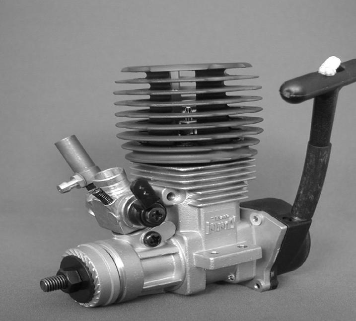

I think these are the spect on the Infinity .18 in the MZT-2S MegaP. Please corrrect me if i am wrong.
Port
3
Displacement
2.85 cc. / 0.18 cu.in
Bore / mm
16.4
Stroke / mm
13.5
Practical r.p.m. Range
4,500~28,000
Weight / g
255
Exhaust
Side
Carburetor
Rotary
Pull Stater
Yes

Donny....
That would be Correct......
Allow me to add a couple facts.....
The Engine you Pictured, is the engine that comes in the 1/10 touring cars. It is a Rotary arm Carb that has only an IDLE screw and HSN. It does Not have a LSN.
The engines in the Mega P vehicles come with a SLIDE Carb and Have HSN, LSN and Idle adjust screws.

Thx Red. Just wondering if that was the correct motor. didnt notice the carb. lol. hope the specs are correct.
