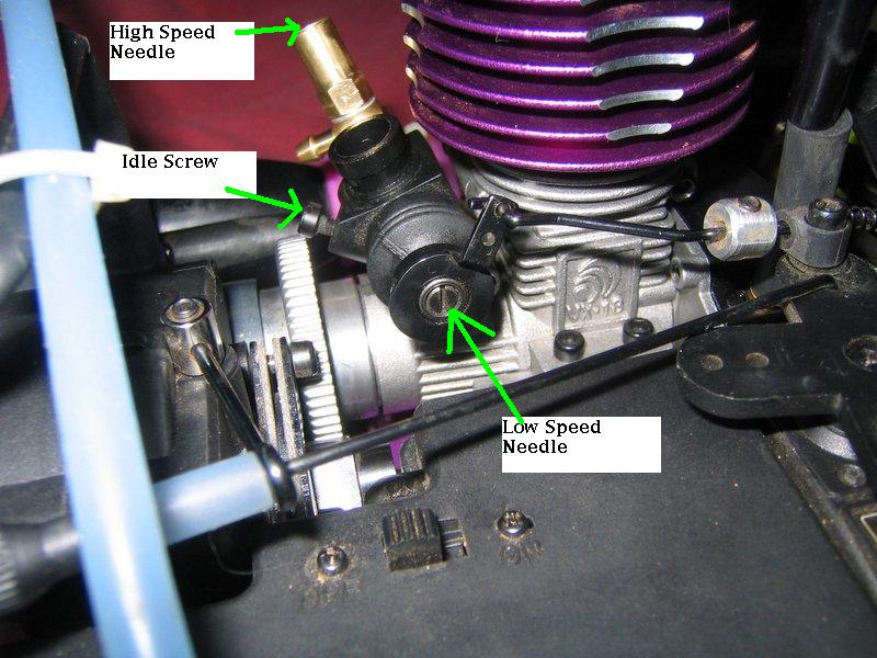

Old 05-19-2008 | 12:31 PM
Joined: Feb 2006
Posts: 16,490
From: howard beach, NY
Default RE: Engine problem Team Infinity .21
ORIGINAL: t0riownageeee
During break in?
Also, were should i adjust on the engine?
There are 1x air 1x fuel screws? ye?
there are probably 2 mix screws, high and low.
Did you break the car/engine in when you first got it? is it a new engine, how many tanks have you had thru it?

Old 05-19-2008 | 05:16 PM
Joined: Apr 2008
Posts: 45
From: Raege, NORWAY
break it?
na....
When i first got it i ran some tanks on it driving slow.....
i guess i have ran like 8-9tanks on it...
how should i use the low/high speed needle?
What does idle screw do?
Old 05-19-2008 | 08:53 PM
Joined: Feb 2006
Posts: 16,490
the high should be 2 1/2 out from closed and the low should be 4 out from closed and the idle screw should be set so the carb has a 1mm opening when at idle and the brake is applied.

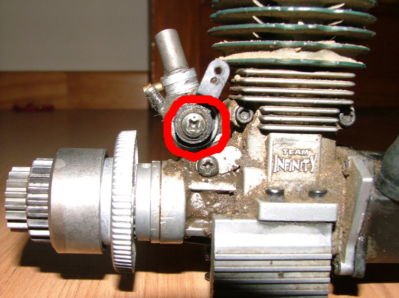

Old 05-21-2008 | 02:54 AM
Joined: May 2008
Posts: 3
From: na, NEW ZEALAND
Hi. I have been having some tuning problems too. is the area in red my low speed mix screw? if i unwind it wont my throttle lever thing (technical term) come undone? the screw is easy to turn once unwound. Cheers

Old 05-21-2008 | 06:34 AM
Joined: Feb 2006
Posts: 16,490
no, that just holds the throttle arm in place. Thats looks like a .18 rotary carb infinity, some of those didnt come with a low needle just a high neede.
Old 05-21-2008 | 12:19 PM
rclynx's Avatar
Joined: Sep 2006
Posts: 3,965
From: Modesto, CA
Judging from the screw in the body of the crankase just below the Carb (thats the one that holds the carb) it has to be a small block infinity [:-]
Old 05-22-2008 | 12:13 AM
Joined: May 2008
Posts: 3
In That case does anyone have any suggestions that might get the engine running properly? It will start, idle and run at high revs properly. but when i throttle off from high revs or it changes into second gear the engine dies. I have replaced all the exhaust gaskets and fuel lines but still have the problems. Can anyone help?
Old 05-22-2008 | 03:07 AM
rclynx's Avatar
Joined: Sep 2006
Posts: 3,965
From: Modesto, CA
If it takes a long time to get into 2nd gear your running to rich [:-]
Old 05-22-2008 | 03:36 AM
Joined: May 2008
Posts: 3
it gets into second at high revs but as soon as it does the engine completely dies, same thing when i throttle off from high revs
Old 05-22-2008 | 06:43 AM
Joined: Feb 2006
Posts: 16,490
try to richen the mix a 1/2 turn
