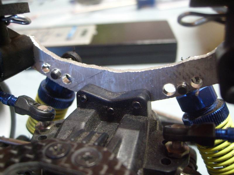

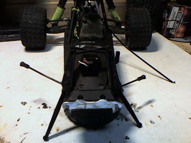

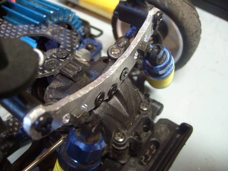

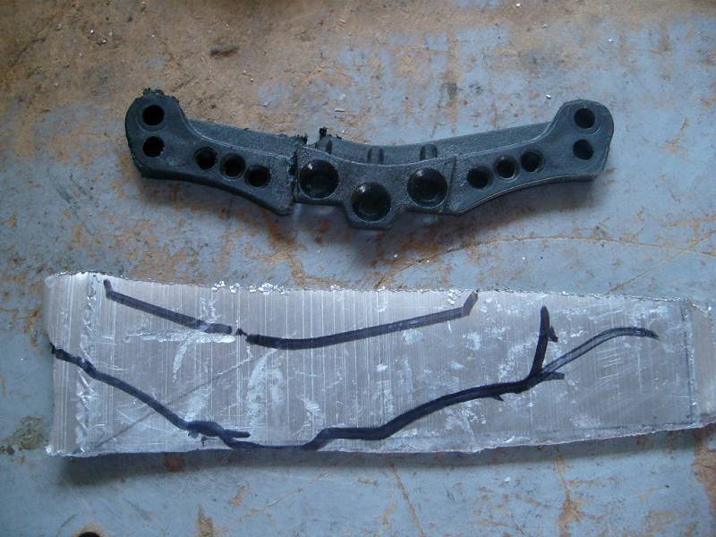

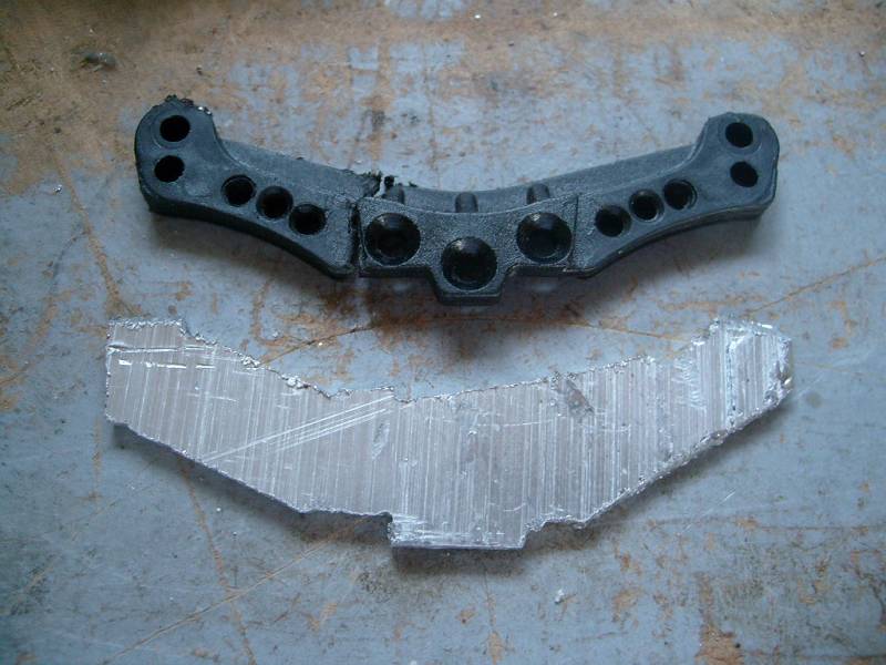

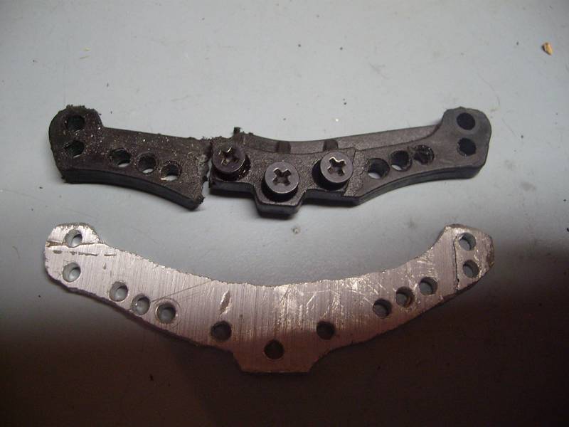

I am curious to see what custom work people are doing. I was driving my brushless recoil for the first time today and I hit a sewage acess (aka manhole) and the car did a frontflip and landed upside down. The rear shock tower broke. This isnt too hard, but here are some pics of my handywork.
I made it out of a spare piece of aluminum. There ya go! free aluminum parts... The pictures show step by step progress.

now THAT is what i call ingenuity, making somethin out of junk, heck, saves on money... if only i broke stuffi could fix like that on my 18T[>:][8D]

thats pretty good. now just smooth it up and polish it[8D]

It saves money, time, and is stronger than stock. You dont need to drive all the way to the hobbyshop to get parts. Whenever I can do this, I do.

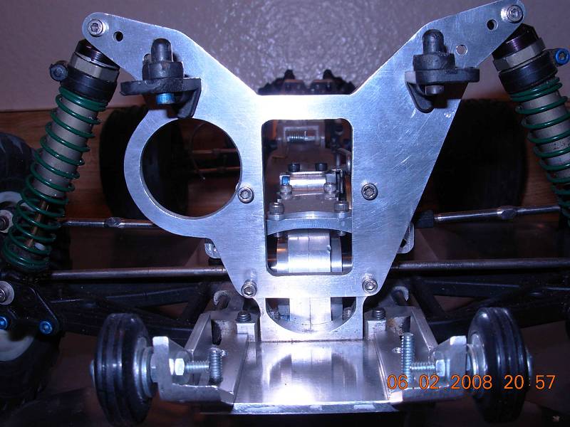

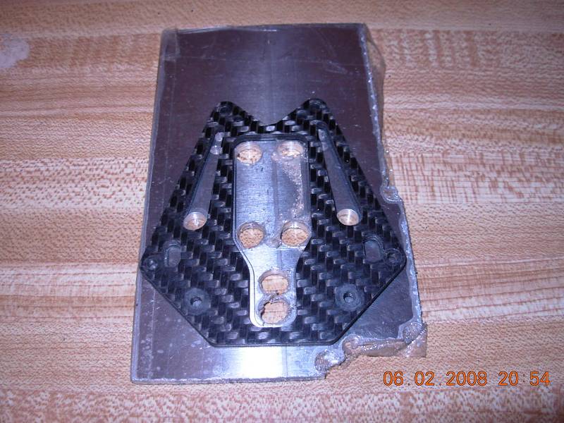

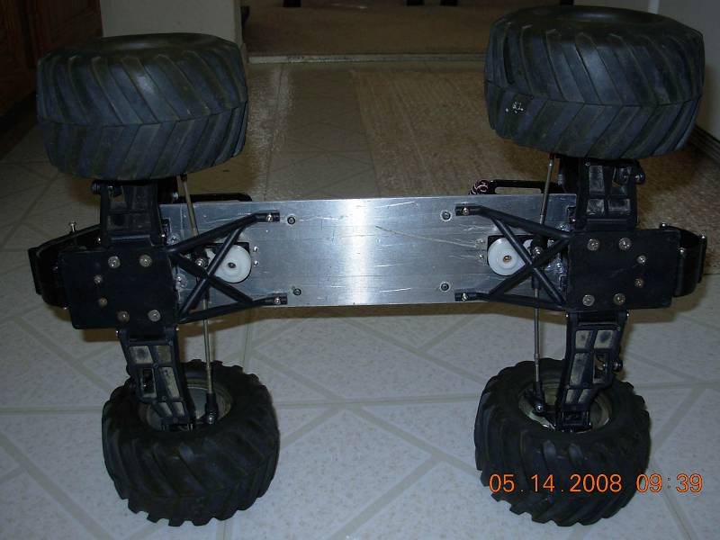

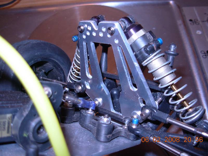

Good effort!
Now with the money you saved. Invest on tools, a cheap jigsaw with a metal cutting blade will let you cut straight and curve lines on a flat aluminum stock. A set of files will also smooth out rough cuts. Sometimes they mail me coupons to use. I got these with a 20% coupon at the same time the drill press was on sale for 49.99.
Then I go to the local industrial metal shop and buy scraps per pound. They are really not scraps, they are nicely cut squares and rectangular shaped. Mostly people buy the dimensions they need and any excess is scrapped.
Made my own chassis, shock towers, etc.
http://www.harborfreight.com/cpi/cta...emnumber=46055
http://www.harborfreight.com/cpi/cta...temnumber=7520
http://www.harborfreight.com/cpi/cta...emnumber=38119

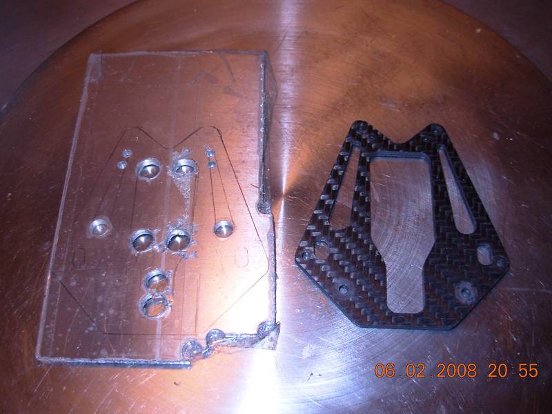

Here is my current project, I covered the metal with clear packaging tape to protect it from scratches while handling it. I will polish it when all the cutting and drilling is done.

I have all those except the drill press. I didn't take as much time as I could of on the filing, but I did do a lot of it. Look at the second picture compared to the fourth picture. That is all filing.
I didn't take the time to get out and set up my jigsaw, I took a hacksaw off the pegboard and started cutting. I don't think the jigsaw is necessary for this. Anyway, if I go to power tools for cutting metal, I usually get carried away and go straight to the sawzall.
If I wanted, I could go all out and file some more and polish and maybe even anodize this bad boy, but I really wanted to just replace the part and get out and drive it.

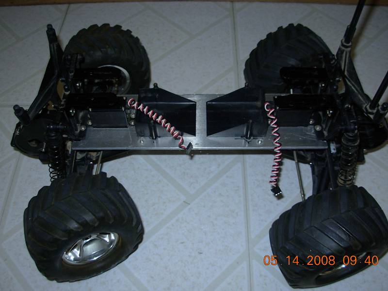

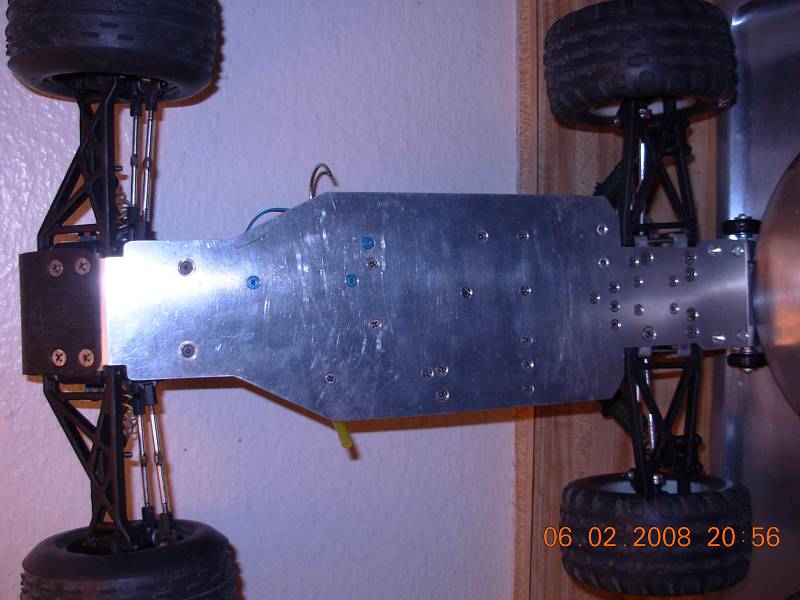

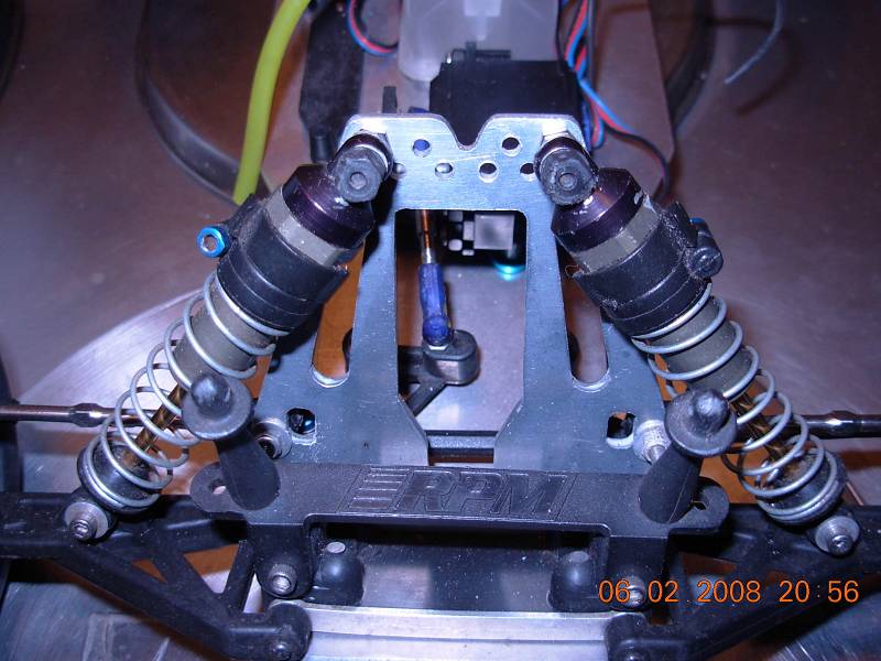

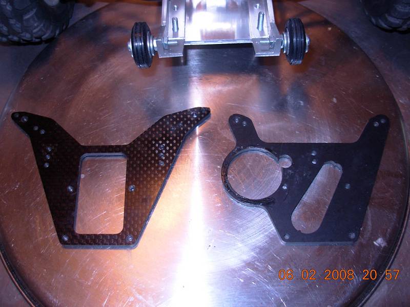

I know what you mean. I get carried away too, and learned that if I take my time and use the right tools, I can make nice aluminum parts.
Here are some more of my handy work.

That's some really nice work. Keep it up. Glad to see I'm not the only one... hehe
I would like to see/know how you do the motor mount holes where you can adjust the motor left to right. They look like stretched out regular holes. Why dont I just take a picture?
How do you make those?

They are called slots.
I'm going to assume you have a set of drill bits, a drill press, and files. Find a drill bit that has the diameter of the width of your intended slot. Drill holes at the very ends of where you want your slot to be. Depending on how long your slot is you might drill some additional holes between the end holes. Then file away until it looks like a slot. The cheap way to do it is to try to cut sideways with your drill bit but its not recomended. Drill press bearings are not meant to take a side load and neither are jobber drill bits. It might be ok with really thin aluminum or plastic but its not good practice.
With a mill you would simply clamp your workpice on a set of parallels, the intended slot being parallel to the X or Y axis. Then you would plunge down with your slot or end mill, move the table to your desired slot length, and be finished.

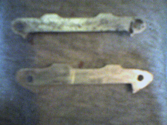

here is some things i made for my rustler. first i made a skid plate for the rear out of a traxxas titan motor can, doesnt look the greatest but it works. then i made a front bumper out of a nozzle for a for a old fuel bottle. it was blue but i sanded it down.
