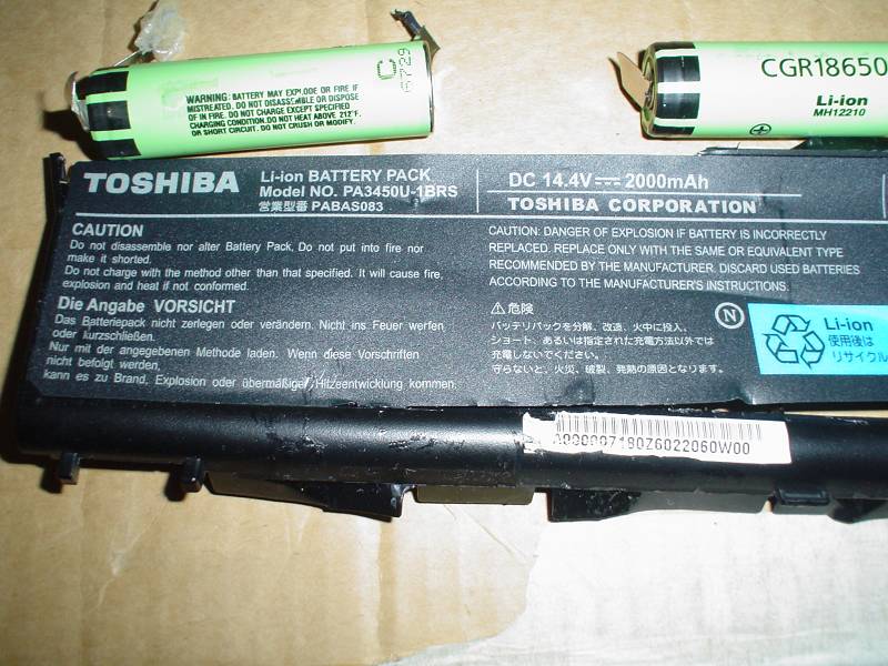

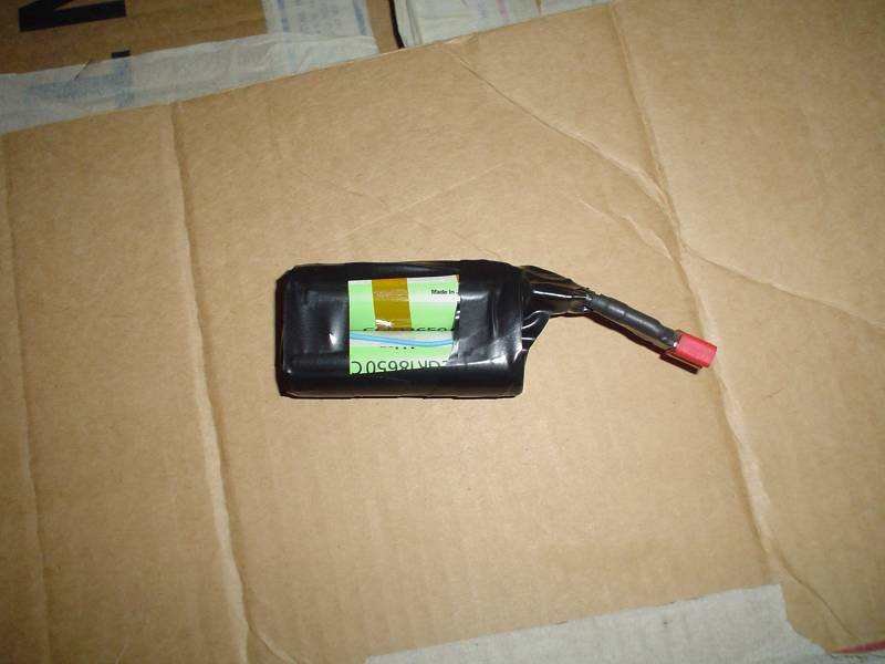

I was given a dead laptop, it is a newer model and I noticed on the battery that it uses Li-ion. I took it apart and removed 4 of these cells. Now it says 14.4v so that would make each cell 3.6v. I thought Li-ion were 3.3v so are these cells not the same as like a123's?[sm=confused.gif] I did throw this little tester together and put it my rc18 for the tire spin test. It looked to me about the same as if I put a nice NiMh in but I don't know what charge the batteries have on them. I see they are 2000mah which leads me to my next question. Is a 2000mah Li-ion battery stronger then a equivalent NiMh or LiPo?[sm=confused.gif] Could a supper brain charger charge these? Also if you can read the warning on the battery it talks about fire and I thought that Li-ion were safe and bulletproof![sm=confused.gif]

I'm not 100% sure ,but those might be li-ions that are lipos that terminate at 4.1 volts/cell when full. Nominal voltage of 3.6 rather than 3.7 for lipos.

There are many cells that look like the ones you have and also the ones that are green and white but because they came from a laptop they are the low current type that at max drain can handle about 2 amps load, over drawing current on these types of cells will cause them to heat up rapidly while they might not burst in flames they will destroy themselves. Good news is that they make great battery packs for your remote and they will last a hellofa long time between charges.
they aren't like the a123 cells at all and you can charge them to 4.20v cell like a lipo. I use them in my remote and aslong as you charge them at 2A and under they will be fine.
I took a 18v li-ion makita drill pack apart and they has cells that are similare to the ones you have but they are 1500mah and 20A max current 2 amp charge. The cells are identical to the green li-ion except the numbers on the side.
if you have 6 cells in that toshiba pack then you can get 2 good remote packs.
