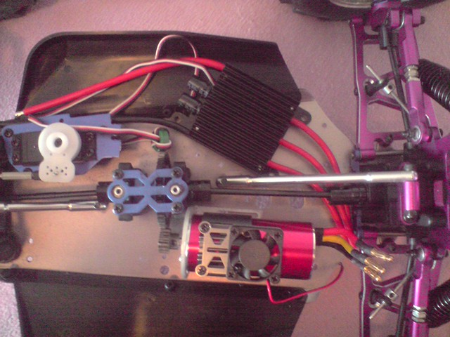

Good info muratt2007 here is as far as I got waiting for parts.
ID:	1024529   Click image for larger version

Just a update recieved my esc and motor have a look now need a battery the expensive part[&o].
ID:	1031684   Click image for larger version
ID:	1031685   Click image for larger version

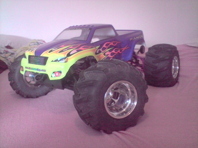

Ok did'nt like my motor mount so found this won that is a perfect fit also got my lipos so just need to do some configuring on were to place everthing but I have a good idea just ordered some velcro straps when I get them will shoot a vid here are some pics.
ID:	1086297   Click image for larger version
ID:	1086298   Click image for larger version
ID:	1086299   Click image for larger version

that looks great bro, let me know how you make out. I love the 1/8 brusless buggy i have, crazy torque.
