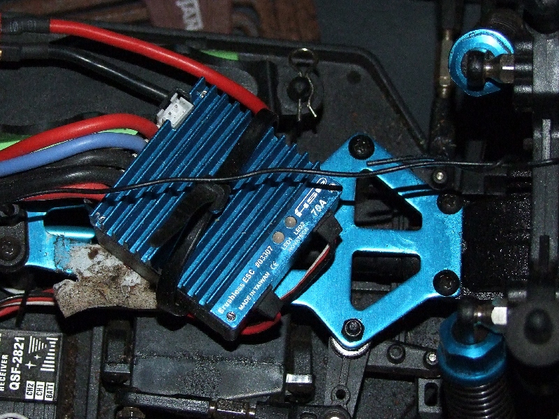

OK. Found it.
Can you do a reset on that vehicle's ESC? I have had trouble with mine from the get-go. Reverse seems unreliable. I know about the braking and the need for a pause. But I keep having to use the trim to get the truck to work properly, then it suddenly wants to have the trim re-set again, or it starts going without my telling it.

sounds like an esc problem.. Depending on the esc you have, there should be a reset button. It may just need to be reset.
If there is a button, Press it for 5 seconds, give it throttle for 2 seconds, brake for 2 seconds, leave it in neurtral for 2 seconds and let off the reset button. See if this helps. If not then the esc is on its way out and wandering.

...no button [>:]
There is a spare set of contacts.....

oh, thats a novatech brushless esc, I dont think those can be programmed, do a search on novatech esc

I have tried a search on just about every combination of the two words, along with others. I can _buy_ them, but not find any info.[&o]
Any how, thanks for trying to help. It's still under warranty. I may have to try to get it replaced
Nick.

here you go, its not programable:
http://www.eflypower.com/download/B4715-CAR-BEC.pdf

Yeah. That _was_ the one I had found. A $70 esc that can be damaged by reverse battery polarity!
Still I will try the revers throttle idea, and see what happens.
One question: Do you know what extra set of contacts is for? Top left hand on my picture.
Nick

its for the cooling fan

Reversing the polarity on the motor leads and the throttle control seems to have helped.
I still like the idea of a programmable ESC though. Looking at a couple of possibilities.
