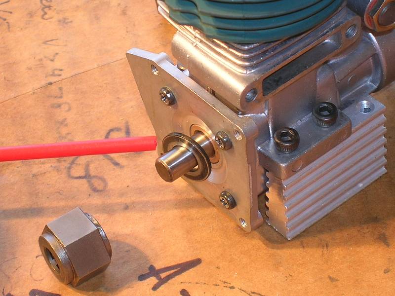

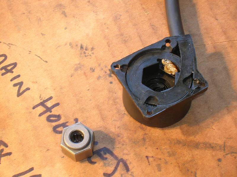

Do you mean the on of switch on the car because at the end you say starter box. Even if you have a failsafe, if the switch goes off, it wont help, you lhs will have a switch for sure, they are all basically the same.
For your electric start, you either have a bad or going bad one way bearing or you have the one way in the wrong way. Did it used to pull fine with the pullstart on, if so the one way bearing is in the wrong way, just flip it around.

when you took the pullstart off there is a nut (what engine do you have, if its an infinity it has the nut) you have to turn it around the other way. With the switch, if its new just contact who you bought it off of and have them send you a replacement swtich.
Sarge.....
Here are a couple pics of the One Way Bearing(OWB).....It's a Similar concept for all engines, even if yours Looks different.
It can be installed backwards, in which case the Engine wont start.
Just take it apart again and flip the OWB around....It should start right up..
