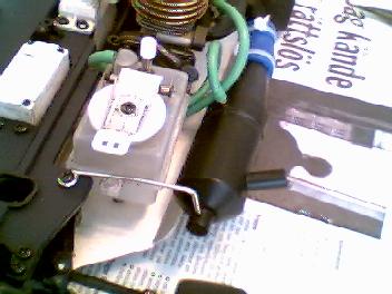

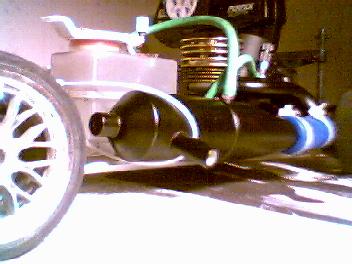

hi, i just bought a very nice and expensive exhastus for my Kyosho. now when i gonna install it, its kind of hard since i dont know what really to fest it whit, its stuck in the end of it but the front is just lying to the ground right now, and I got this little metal stick, a long silver colored iron stick whit some circle hole in the end, Dont know what to do whit it eiather..
http://www2.gpmd.com/image/k/kyoc4658.jpg
Its that stick i was talking about... no clue what to do whit it , anyway if i take a normal wire made of plast or something... it might burn or melt... so im not really sure what to take...
please send pic's or a nice explanation and not like the one on my manual

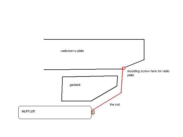

the "stick" needs to be mounted to a body screw or some other nearby screw. I don't have a pic here at work but there is one that mounts the radio plate on mine, pull that screw out, slide it in the round end and screw it down.
the other end (not the rounded one) goes into the front of the muffler, there should be an allen screw in there, back it out a bit and put the end in there. Lemme draw up a quickie pic for ya..be right backk

hope this makes sense, doing it from memory and well, mspaint isn't the greatest

you probably have to bend that "stick" a bit to make it fit depending on how yours is setup, but i hope you get the idea. Let me go look and see if I can find a pic somewhere..

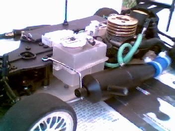

okay heres another one. i circled in red the part where the "stick" goes. You can kind of make it out going to the screw there just in front of the gas tank

Hey, thx i see what u mean but the manual says i have to drill a hole in the chassi to do so.. and the problem is i aint got a drill
Old 06-25-2003 | 07:15 PM
Joined: Jun 2003
Posts: 145
From: , ,
Default Emergency help - installin Muffler
also, there's a nice hole in my fuel tank that i maybe could use...
but no idea what to use to bind them toughter... also whichever ´way i do, the exhautus will crap to the chassi if i do any quick turns so thats another problem..

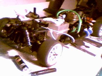

look,

Before pic's -

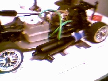

Now - Now i fixed it like this temporality till the Material stores open... Or till i know how to fix it

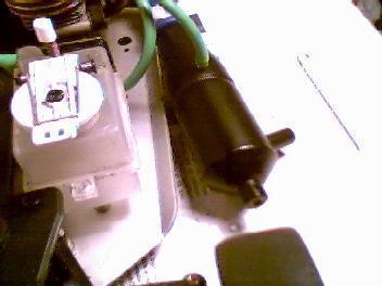

And now the last one , well u see, if i'll have it something like this, the pipe will scratch to the chassi as u saw on the first pictures... thats problem 2 ... maybe i should put some silicon or some better type of plastic.. What do u guys think?

problem fixed Heres what i did Took the Metal stick and did attatch it to the chassi , then we did just change the rotation of it and woalla looks nice..

last one, this isnt what it said on the manual but well, the manual says nothing anyway, How do u think this will hold now ?

sweet thats EXACTLY how mine is attached. You can't really see it in that one pic up top that I found but that's what I was trying to get at lol. Good job.
