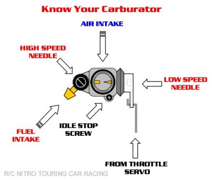

It wouldn't start. It would only run with the glow plug igniter on. When I did get it to run, the RPM's went to like 50,000 and it stopped. Never could get it to start again. I'm trying to get some help in the Redcat Racing sub forum. I was given some suggestions on how to set the carb to try to get it running. Wish me luck. My fingers have blisters on them I pulled the starter so many time on Saturday. I do however, get my Sidewinder System for my Rustler today.
Old 08-31-2009 | 10:32 AM
Joined: Feb 2006
Posts: 16,490
From: howard beach, NY
Default RE: How are yall doing?
ORIGINAL: dakotanut
sounds like you need a new glow plug and your setting are all messed up.
You need to be sure with the radio and car on, there is a 1mm gap in the carb opening. sounds like yours is bigger since the rpm's revved out like they did.
you also need to set your low and high needles.
the low needs to be set 3 out from closed (3 full 360 degree turns counter clocwise)
the high needs ot be set to 2 1/2 out from closed (counter clockwise)
This should get you up and going, if your engine is set to rich you may need to keep the igniter on it to keep it running so try the settings i gave you before you swap out the plug. I put a picture for reference for you

I put the glow plug on the igniter and it glows pretty good. Burnt my finger doing this. I'm just concerned that I burnt up this motor. I would hate to have that happen. I don't know if I did or not and would like to be able to know if I did.
Old 08-31-2009 | 01:07 PM
Swamp3r's Avatar
Joined: Jan 2008
Posts: 1,403
From: Edmonton, AB, CANADA
Even a bad plug will glow, but it doesn't mean that it gets hot enough or stays hot. I would replace it like Eddie said.
Old 08-31-2009 | 01:24 PM
Joined: Feb 2006
Posts: 16,490
ORIGINAL: dakotanut
Like Rod said, a bad plug can still glow but will loose its umph once the igniter is take off. Compression is the best key to an engines shape, a good test is to hold the rear of the car off the ground by the pullstart, let the car go and it should either be held up by the pullstart or should fall slowly, it will fall a little then stop, fall a little then stop, if it is falling quickly then most likely the engine is shot, also do this when its cold not when the engine is warm. It sounds to me like you have a tuning issue.
