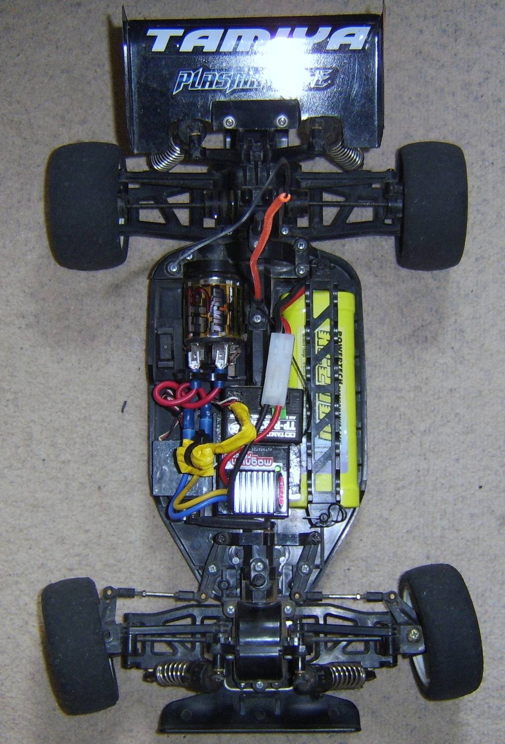

<span style="font-size: larger;"><span style="color: rgb(128, 0, 128);"><span style="font-family: Comic Sans MS;">wires are connected correct .
i've taken a pic so you can advise on alterations</span></span></span>
<span style="color: rgb(128, 0, 128);"><span style="font-size: larger;"><span style="font-family: Comic Sans MS;">
and thanks for replying so quick</span></span></span>
you need to upgrade your connectors for both the motor and the battery.
it also looks like you have no capacitors on your motor which can cause excess feedback.
also don't wrap the wires together like you have on your reciever, that creates feedback/interference.

The servo wires can be bound like that but get the receiver antenna out of there. You're probably picking up interference from all the electronics. It's pretty cramped but try to keep the receiver wire away from all other wires, motor and esc as much as possible.

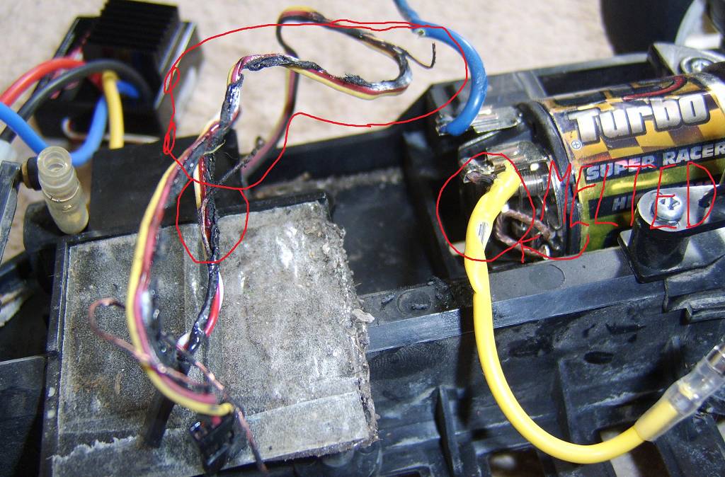

Only took the thing out for 5 mins to see if re-arranging componants would sort out the interfearence which to be fare did help (getting antena out the way) still done it tho but went a little further than before
Then all went t!ts up .......as you can see from picture ....she just all of a sudden stoped in the road and burst into smoke servo wires fried , esc wires fried and engine wires fried , just missing some bacon and eggs
I'm learning a hard and expensive lesson lol
lets just say mine heat up as well

That's too bad... One of the things that electric guys forget is that a temp gun is your friend as much as it is for nitro guys. Especially when you are trying anything new, check the temps.

I can understand why the battery and engine leads melted but why did the rest?
was it because they were close by and got caught in the mix?
I've done a bodge job and taped up the esc to see if she'd still work and she does

I would really suggest that you replace the servo wire, it's pretty cheap and easy to do. Also, you have got to replace that molex/tamiya battery connector, those will heat up and melt with good batteries and high draw motors.

Id say it burnt up cos those wires got hot and touched.melted the wires [

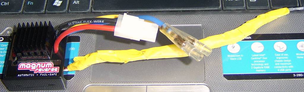

you need to get rid of that Tamiya connector, if your not confident with soldering your LHS should do it for a few bucks.
also, what battery are you using? a low quality pack or a pack with little charge in it will cause stuttering.

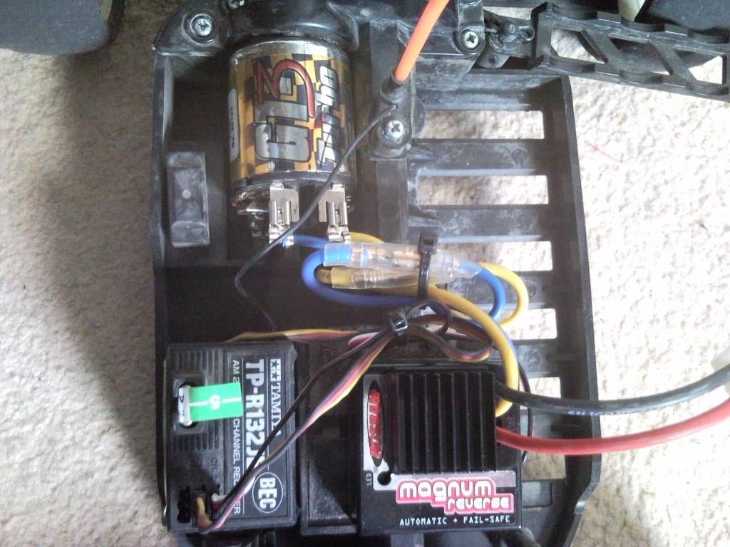

Right it's definatly not the receiver...tried another and exactly the same so what i thought next was changing the motor to an old 15 turn just to see if it is the connections not being able to handle to pull off that 12 x 2 like you guys said and i can confirm it's 100% that because the 15 turn went all the way without any splutter
Thanks to all that have helped and those who said connections well done
now i'm stuck as this is the part i dred the most because it's out of my capabilities i think
included a pic to see if you guys think this is tidy enough as well?
excuse the insulation tape around the esc lol she got a tad burnt last time round and needed dotoring lol

Just been flicking through internet for Deans connectors and just want to check with you guys that these will help solve my problem?
Thanks.
Thanks.
Joined: Apr 2007
Posts: 8,958
From: Thousand Oaks,
CA
Yep Deans 100% Tamiya plugs are like the brick phones, they work but are horid to begin with. Do remember the lower T of the motor, the higher power it draws....
