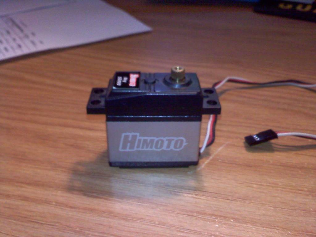

NEW HIMOTO 9001 SERVOS!!
These new servos are the bomb guys. At first it looks like a nice shiny metal sticker on the outside of the servo with a HIMOTOlogo. Well it turns out to bea aluminum servo housing. The housing is pretty thick also. The inside is layed out different too. A 9001 9kg servo is 125 oz. in. with metal gears.

Old 06-28-2010 | 09:38 PM
Joined: Dec 2009
Posts: 211
From: Altoona, PA
Default RE: Servos
Does anyone know the speed of this servo. it seems pretty slow to me. I cannot find anything on it. I do know that its about a 125 oz/in. servo, but dont know speed.
