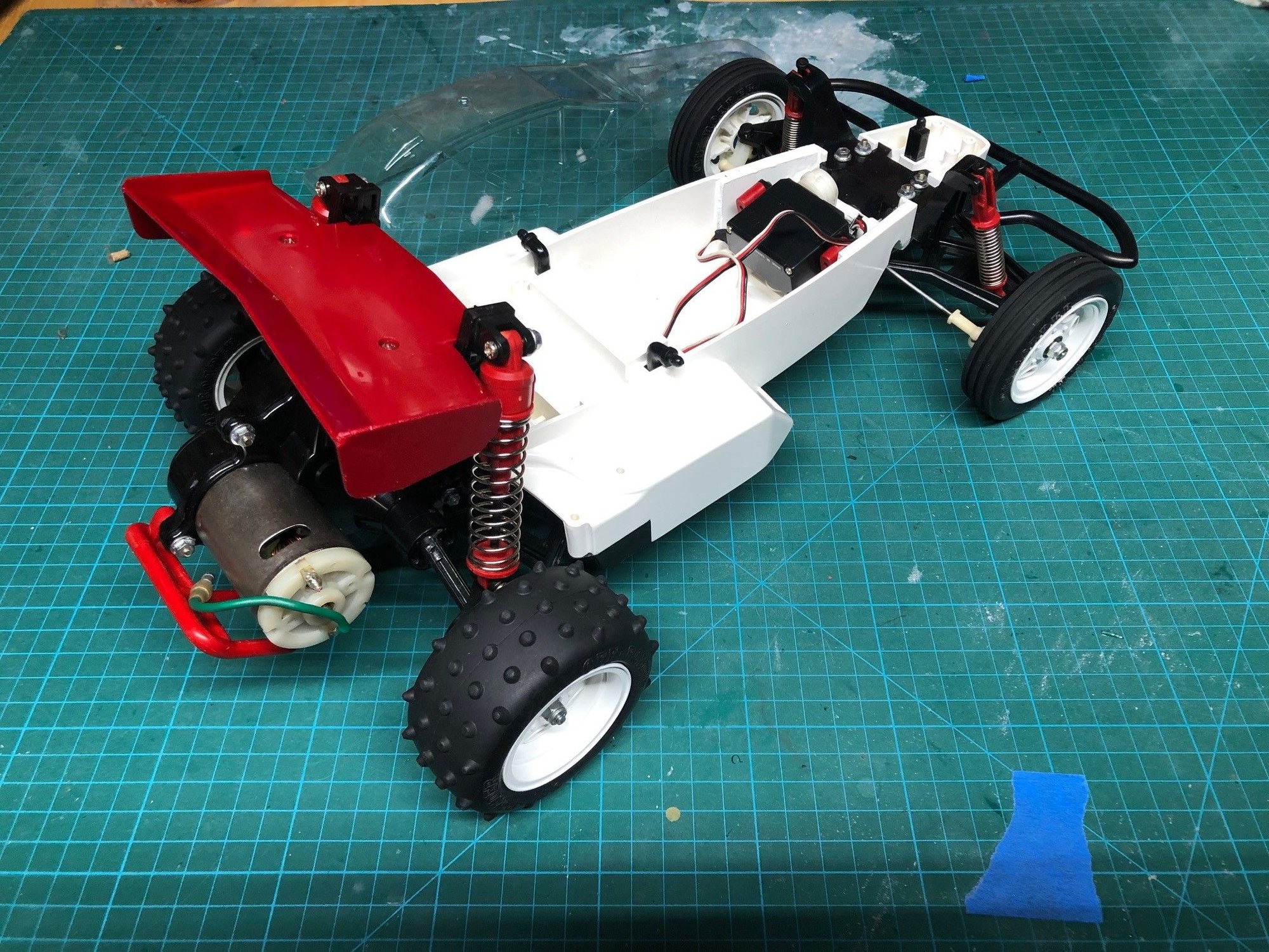

It's been almost 10 yrs since I started this thread. In that time my interests have strayed away from RC and into other hobbies like auto racing, mid to high power rocketry and a bunch of other little things. While I took a break from building and actively running these cars daily, I've never stopped collecting and have kept up with all of the Tamiya special releases and all of the re-releases from various manufactures. I feel like I lost interest due to the limited space I had to run these and the one track we had locally closed up so I pretty much just put things away. I have recently purchased some land that will allow me to build my own vintage friendly track so I'm happy to say that I've been back in the hobby for a few month now.
As luck would have it I was at a flee market a couple of weeks back and stumbled on a seller that had a large box of misc. RC car parts. Looking through the box I was excited to see a couple of half built but never completed Strikers, an almost completed FX10 and a couple of of fairly well used FX10 Chassis's along with a bunch of new and used parts in bags and containers. I was able to pick up the entire box of parts for a very reasonable amount and it reminded me that I never finished this thread. After Picking through the parts I decided that I wanted to do two different builds.
The first build will be a runner and be documented below. This build will have modifications to the chassis for strength, run bearings and modern electronics. It will look very much stock but stronger with better parts. For this I'm not concerned with scratches on parts etc. The used parts will be what are going into this build. The second build will be a 100% stock build with all original parts including vintage radio gear. This will be a shelf queen that will be done in box art and never driven.
Enough with the back story. Lets get building. Below we see the main chassis. This is a well used chassis that was sanded, filled and painted to make it presentable. Three coats of Duplicolor basic white was what was required to get it to this point. The major issue with these cars were the front of the chassis. It's near impossible to find one that isn't broken or cracked in some way. To strengthen the chassis area I have used 1/8" ABS sheet stock cut to fit the inside and under the chassis. This has been bonded to the tub.
Main Chassis. Not the addition of 1/8 ABS sheet stock to strengthen the front of the chassis
Main chassis underside. Additional bracing was added in the forward locations as shown for strength.
Next up installing the front body mount, Shock tower and rear body mounts. The front shock tower did require screws that were 1/8 longer than stock as they needed to pass through the extra thickness of the ABS sheet. The lower battery door mounts were also installed underneath.
Then it was time for steering. I have a bunch of these old school Futaba S148 servos so I installed one along with the stock servo saver and tie rods.
Next up was the control arm, lower shock mounts along with the axles were installed using all of the original hardware.
The A-Arms were attached to the chassis, springs installed and tie rods attached.
Now for another major upgrade. Continuing wit the strengthening theme, I added the CRP front chassis brace and bumper. This is a really nice and inexpensive kit that really helps save the front of these cars. Used along with the bracing I've done to the tub, there is zero flex in the front end at this point. I wasn't sure i was going to like this bumper but now that it is on the car I do like it.
And the final progress for the day was to tackle the gearbox. The gearbox was assembled with bearings throughout. I used marine grade waterproof grease on the gears and assembled the gearbox with the original hardware. Everything is nice and smooth.
That is all the progress I made on FX10 this past weekend. I'm hoping to get the rest of the assembly done this week and having a running driving car next weekend.
Thanks for following along.

Made some additional progress last night.
Attached an old silver can to the gearbox. Feel like the old silver can be plenty of power for this old car. Next I attached the gearbox to the main chassis.
Assembled the swing arms with bearings and install on the main chassis.
Assembled the rear upper shock mounts and original shocks. Attached the rear shocks to the chassis.
Getting close. I assembled the wheels and tires, Attached the rear wing then through on one of the old original bodies for right now. The body has never been painted but it is in rough shape. Still good enough to use for running but I have a couple of TBG bodies on order.
Currently i'm digging through my parts for electronics. Looks like this one will end up running Traxxas radio gear and the XL5ESC.
After I get it running I'll get the bodies painted up and decals applied.

Finally had a chance to apply the decals to this one. I'm happy with the way the project turned out.
As some of you might have noticed, I never put electronics in this car. The reason for this is that I was contacted by a member that saw the build thread and offered to buy the car once the project was completed but didn't want any electronics and didn't want the car to be driven after the restoration. We reached a deal and I'm happy to say that the car is already in the hands of the new owner safe and sound. I don't know if he will post here but it has a new home.
For now, here are the final pics of the car.
