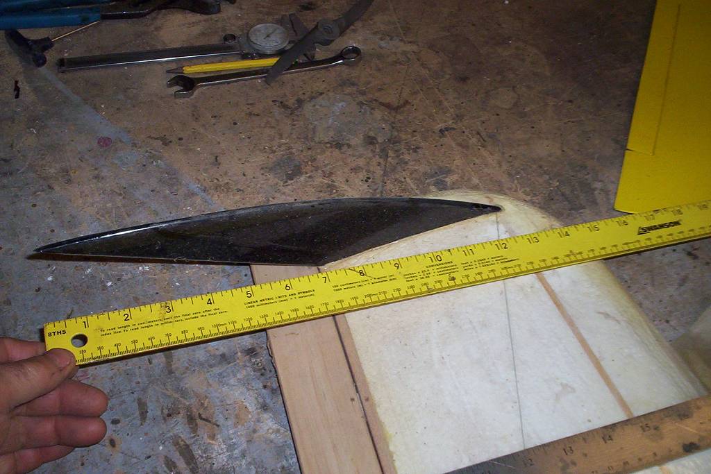

Gary, I take a well seasoned AMA Fast or 80 mph plane to start with. The one you see here is a Steve Hills style plane with a poplar motor block and aluminum arrow shaft boom.

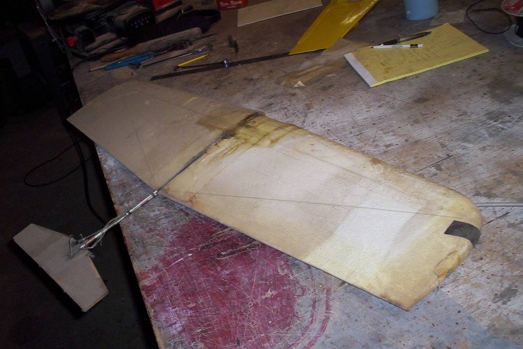

First step is to hack off the stabilator.

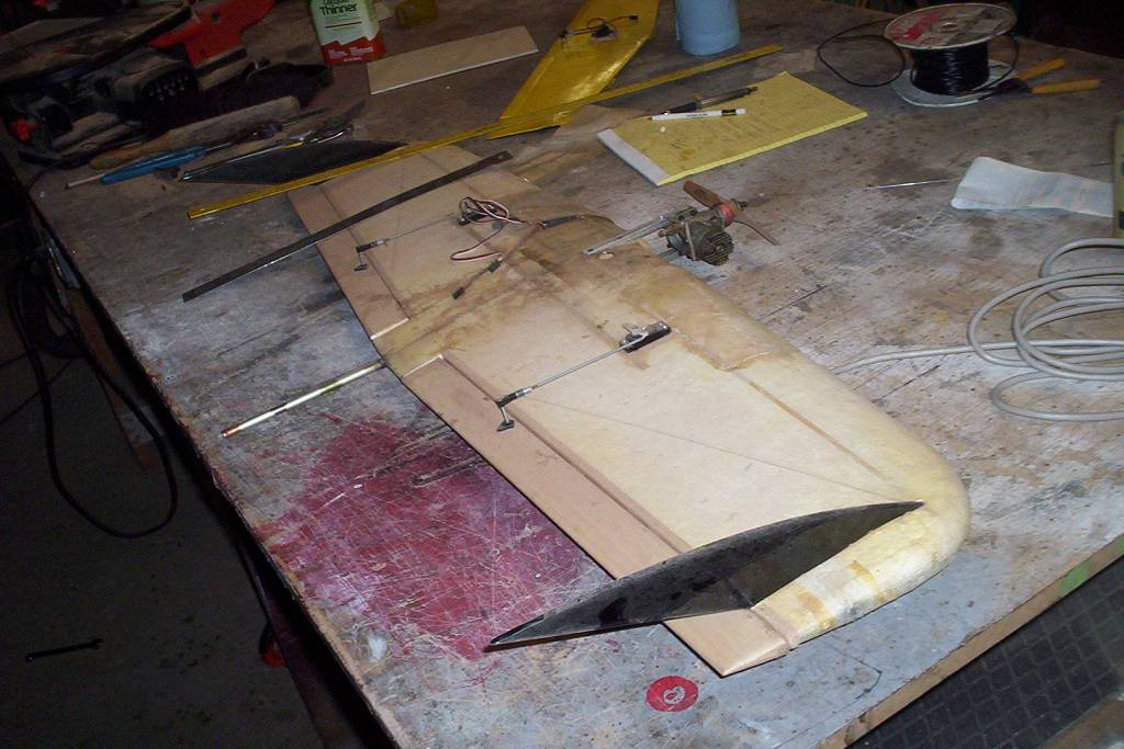

Next, I cut into the wing to create "reliefs" so that the elevons blend into the airfoil. This is just a judgement call. The important thing is to glue trailing edges to the wing to give the elevons something to hinge to. I use bamboo skewers to anchor the trailing edges to the foam wing.
The elevons are 1 3/4" wide.
The servo mounts are plywood, the idea is that they are recyclable from plane to plane

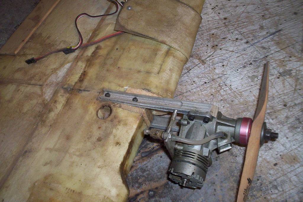

The engine mounts are longer than what you would have with a controline plane.
I machined them on my drill press with a cross slide vise and a mill bit.
I used the CG calculator at Geistworks. IIRC it flies at 10-15% MAC. Be prepared to fine tune that for the best glide and control response that you like.
You are obviously a pretty knowledgable and resourceful Combat Guy so you shouldn't have any trouble making something like this work.
The fin area is enough for decent tracking, even with a streamer hanging off a wing panel, but a central fin would be good for a real combat machine.
