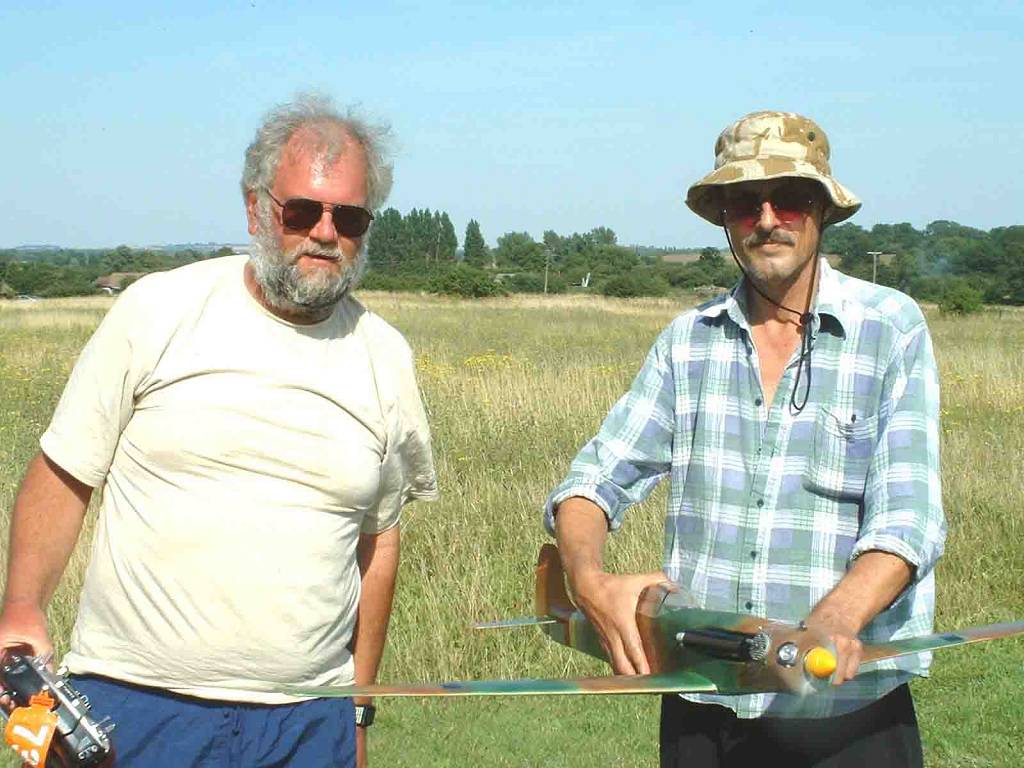

Mine were home built from an Aces plan in blue foam and brown paper on the fuz with a little glass reinforcing. The wing I covered in 1 oz cloth and one coat of resin.
MVVS 20 on the mini pipe turning a APC 9x5 JUST inside the limit on the ground but in the air - well lets say I liked being the fastest kid on the block.
