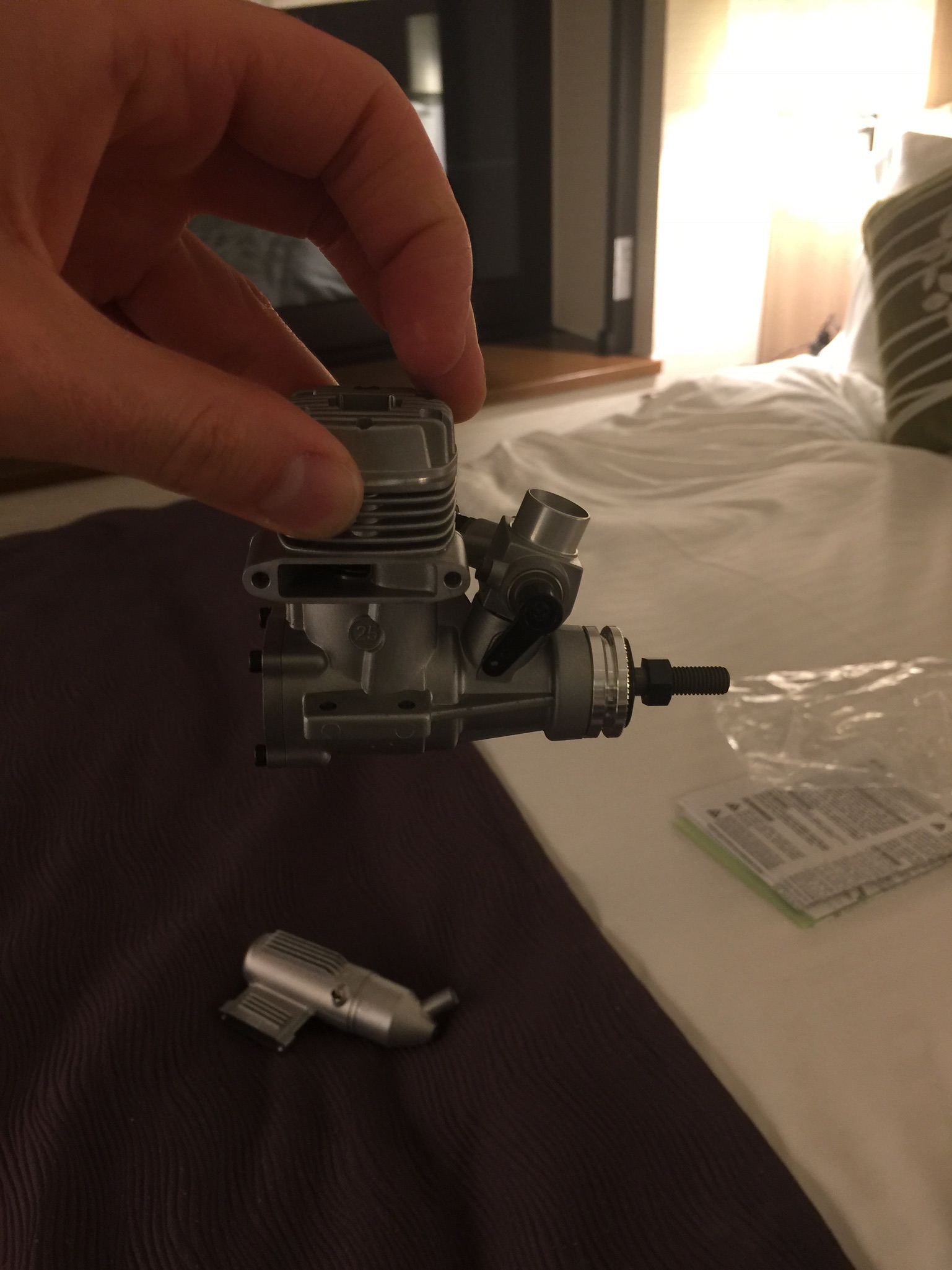

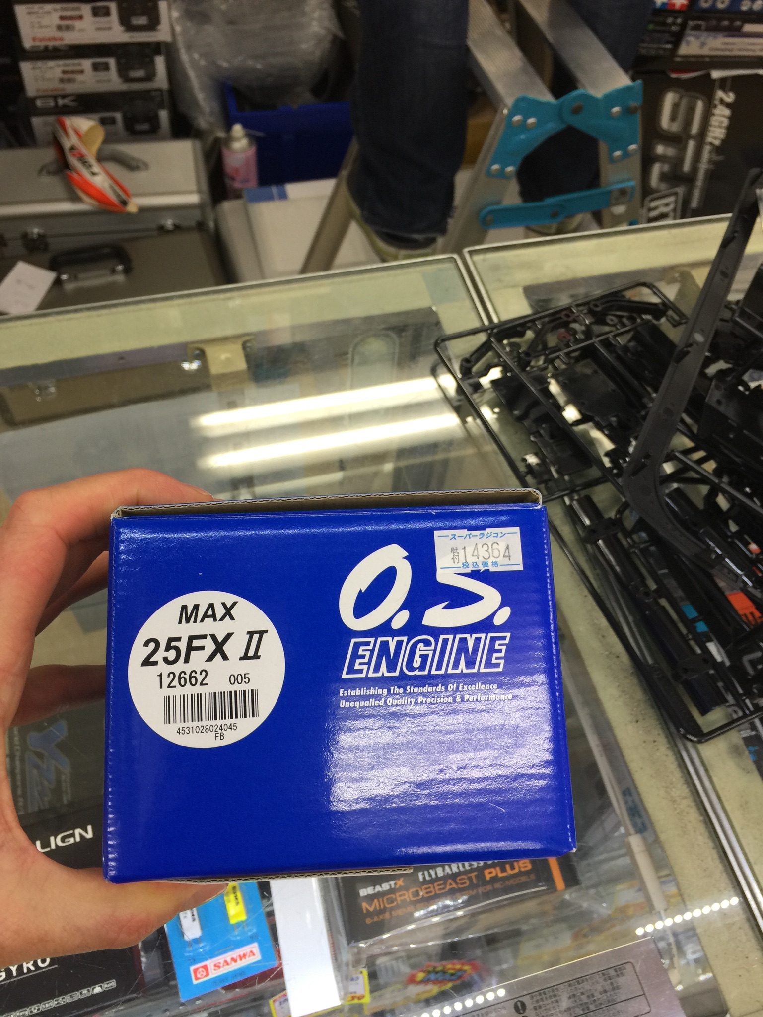

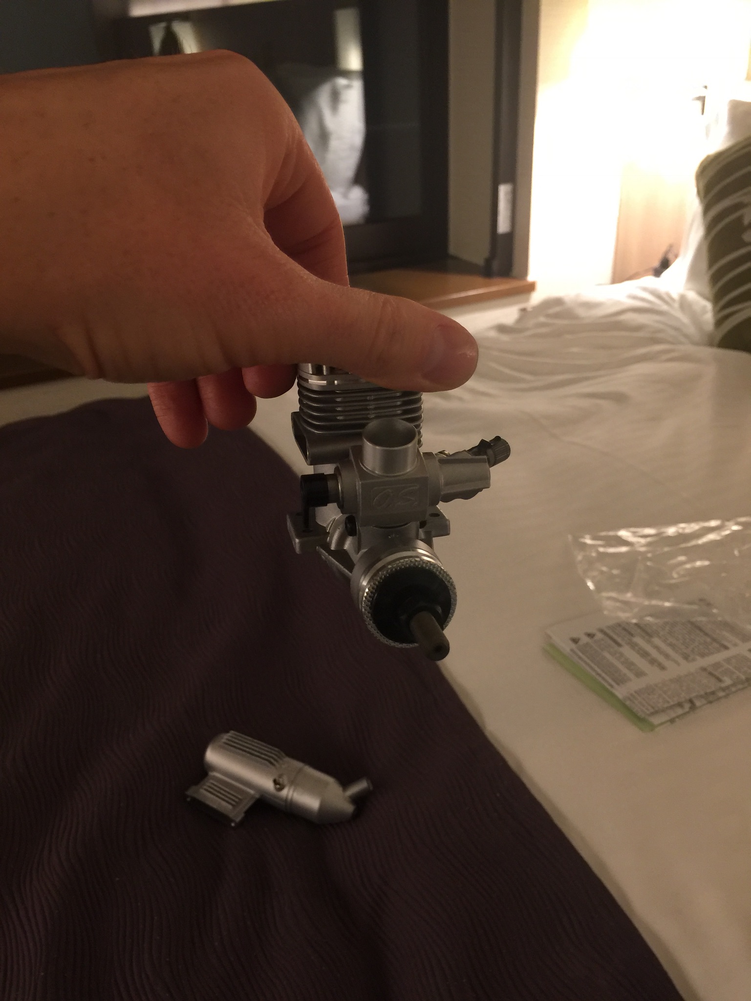

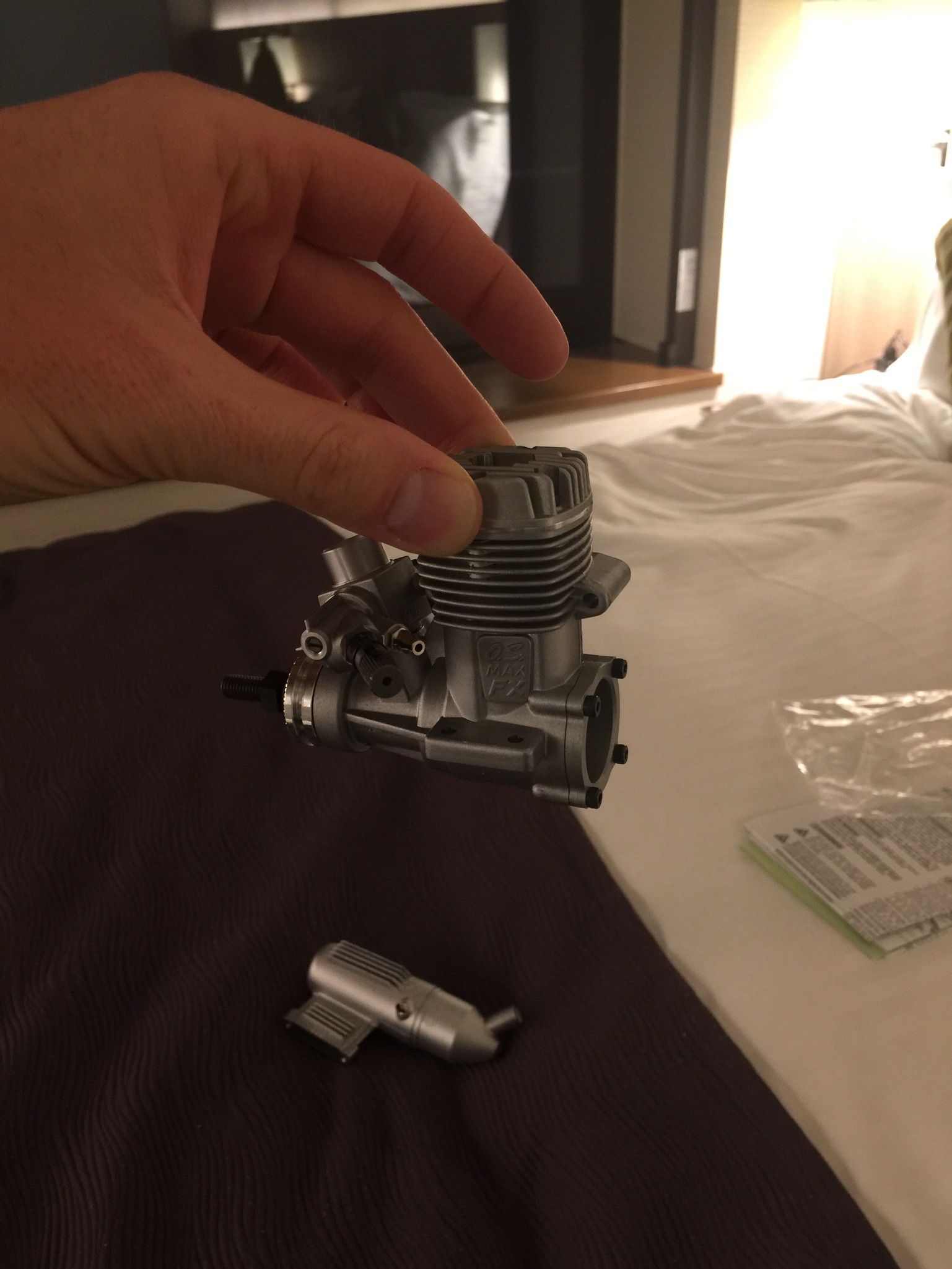

Good news,
My travels took me to Japan this week and I visited RC Radicon in Tokyo. I asked about a replacement for OS 25 FX and sure enough there is one. It's the OS 25 FX II. I picked up two. Here are some pics. Will be available later in the US.

Looks like a good setup. Maybe a better carburetor?

How does it run? Looks like it has the needle angled back, like the AX series.

I have an AX .25, I don't know why it was discontinued, and then this one brought in. According to the site, the Weston will do 15,900 with an 8-6" APC. That is only a bit better than an FP or good LA .25 which was also discontinued here. At least they are bringing back a .25. A really nice size that is often overlooked. I like the angled back needle valve too. They still use the weak screws holding the carb on instead of the clamp though. I guess they sell more cases that way.

The FX II has the same compression as the FX at least on my tach. The FXII Copies the AX carb/HS needle design. I always got more RPMs/power out of the FX engines opposed to the AX. So basically the FXII gives the you the power of an FX with the convenience of the angled back HS on the carb.
