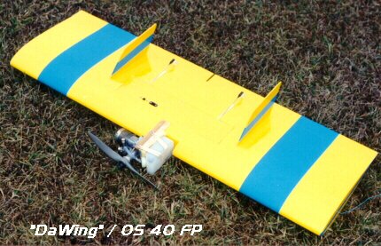

Default King Kombat
For your King Kombat's initial flights balance it on the front edge of the spar. Set your elevator throws to 1/4" up and 1/4" down.....and set the aileron throws to 1/2" up and 1/2" down. As you move the CG rearward, it will take less elevator travel to stall it.....but the rearward CG will make it more maneuverable.
Back in 1979, several of us around here built and flew King Kombats. Initially we powered them with OS 25 bushing engines, but later changed to the K&B 3.5cc engines to get more power and speed.
We also discovered that if you left the wingtips off of the King Kombat, and used a K&B 3.5cc, the elevons would flutter in a slight dive. Since you are planning on using a Magnum 40GP, be careful because your King Kombat could easily go fast enough to flutter the elevons.
Eventually, our King Kombats evolved into a plane I called the DaWing, which used foam wings, OS 40FP engines, and had a modified elevon design that completely cured the flutter problem, even without the wingtips. In fact, I used to have a DaWing powered by a Rossi 40 just to go blazing around the sky. If you visit my DaWing web page, you will see the distant resemblance to the King Kombat.
http://mypage.yhti.net/~dmcdnld/dawing.htm

The short answer to how much reflex you will need is......."It depends on your CG."
On a flying wing with a symmetrical airfoil, the reflex needed in the elevons is entirely dependent on the CG location. The more nose heavy your King Kombat is, the more reflex it will need to maintain level upright flight.....AND the more control surface deflection it will require. The further aft you move the CG, the less reflex it will need, and the less control surface movement it will require. In fact, if you move the CG location back far enough, you will eventually find a "sweet spot" for the CG where no reflex is needed at all. And with the CG at the "sweet spot", the plane will fly straight and level upright, and also straight and level inverted without having to retrim the elevator. For combat, this "sweet spot" CG works great! It gives you maximum maneuverability, and the plane simply goes where you pointed it last.....no matter whether you were upright or inverted.
For your initial test flights, I'd recommend setting the CG at the front edge of the spar. Then adjust your linkages to get about 1/16" of up reflex in the elevons. This should get you pretty close for the initial test flight. Once it's trimmed out and back on the ground, be sure to note how much reflex was needed for your particular CG location.
To handlaunch the King Kombat, have a helper grab both wingtips, rev your 40GP to about 1/2 to 2/3 throttle (not full), and give it a gentle push at an upward angle of about 30 degrees. The partial throttle launch will quickly get you up to flying speed, but also allow you some extra time to make any needed stick corrections. Once it's been trimmed, handlaunches are much easier. It simply goes where the handlauncher aimed it.
And after the initial trim flights, you can easily handlaunch it yourself. Using the left hand, wrap your fingers around the leading edge next to the fuel tank, and place the thumb across the top of the motor mount. Set the throttle at about half power, and give the DaWing a slightly upward and forward push before releasing it. Once properly trimmed, it will fly right out of your hand.
With an OS 40FP, no muffler, and an APC 9.7 prop I once clocked a DaWing at 117 miles per hour, or 188 kph. I would expect a King Kombat with a Magnum 40GP be similar in performance.
