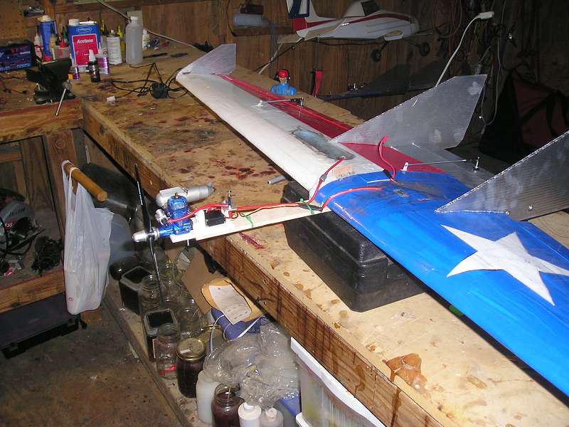

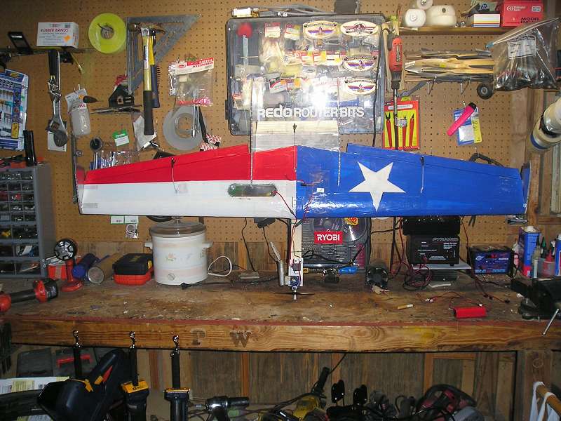

read the last two pages of the http://texascombat.com forum on cobra. I built two cobras as per instructions. I had to add 8 oz of weight to the standard length nose to get it to balence. Another pilot in my club built a cobra totally independantly and had to add the same amount of weight. I removed the weight and extended the nose until it balenced. I talked to lee little about this. mine weighs the same as his(if i remove the 8 oz). he uses a heavier motor mount and a stabdard size servo for throttle. The test flight will tell me today. If it flies well I will just make a few spare tongues that can be field replaces and leave it that way.

If Lee is using a heavier servo and engine mount, and his plane weighs the same, then you have extra weight at the rear of the plane, or gear mounted farther back, and you're haveing to balance it out.
Nothing really wrong with that approach, as you know, I was just asking since it looked off.
I would consider putting a teather on that engine though, that mount looks like it's asking to be ejected in a mid-air.

Looking at your top picture, I'm guessing, but I think your servos, RX and battery are mounted a bit farther aft than I've seen on some Cobras. I could be wrong though.

I had somebody else build the cobra I'll check the locationa and see if thay can be moved further forward. The rcvr and battery pack are as far forward as possible. I will check the servos.
