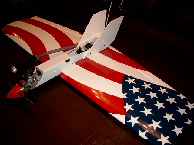

Beautiful plane ysrcflyer!
My first gremlin I just finished last week. My plan is to learn on it until the combat season starts up again next year. I only have a .46 which I pulled from my trainer, so it's a bit fast ;-) Jumping from to a trainer to a combat gremlin was a hoot! I took it out for it's maiden flight by myself too... That was one wild ride! New radio, new plane and it was the first time I "crissend" a plane myself. There were 30kph winds, but what the hell I thought. It initially wanted to dive as well. I was so out of sorts I could not even glance at the new radio long enough to trim it out. I manged to compensate for the diving and the wind pushing it all around. Came in with a nice gentle flop. I found after that first flight I was all jitters for a bit. I can tell you, that was the most fun I'd ever had. It was like learning to swim by just jumping in.
I called it a day. The day after I took it out after making adjustments. I managed to get really comfortable with it, doing low passes at top speed coming out of a dive. The fuse gave way at one of the bolts and I lost control. Cut the throttle and managed to keep it in the air long enough to loose some speed before doing a nose plant. I guess the PVC pipe already broken; took the brunt of the impact, as that's all that appears to have broken.
Now I just can't find 2.5" replacement PVC pipe. I've looked everywhere.
