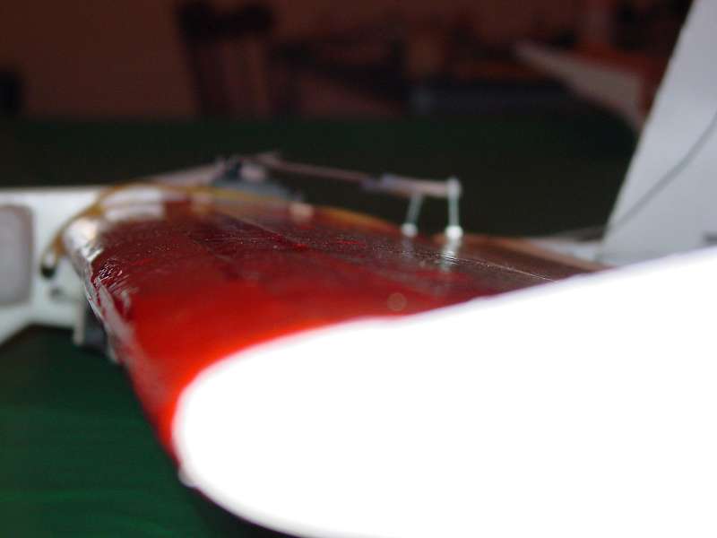

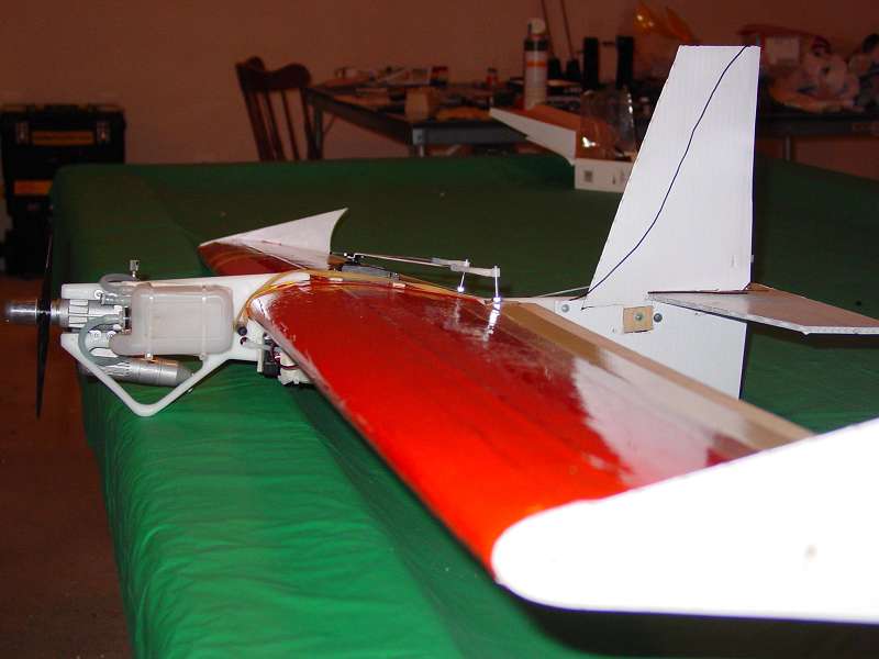

Does your wing have the spars sticking out, or do you have a nice smooth top of the wing? I've seen an number of Lanier planes built so that the spar sticks up and makes a lump. That lump seems to affect the ability of the wing to generate lift. It certainly doesn't help anything.

Montague, I did make a new wing for the plane. And I did put the leading edge plastic guards on. Granted I did a much better job on the spar as its not sticking up through the wing. Well it is but a very very small amount. Again with a little too much glue. The streamer I was using was an extra streamer that i had from the combat event. So its the standard crepe 1 inch wide streamer.

The wing spar thing I mentioned before could be a factor. If it's big enough it basicaly acts like a spoiler.

Well my streamer is just tied on to the vert stab at the end. I have about a 6 foot lead to where the streamer itself is tied on. As for the wing spar granted its protruding just a small bit. Ill see if i can attach a photo of the wing and you could deside on it.

I attach my streamer to the thrust line or as close as possible to it. Imagine a line coming out the back of the motor and follow it to the end of the plane. In that area is where I attach the streamer so I get the most consistent flight characteristics with or without it.

If you're putting the streamer on the top of the vertical stab, that will cause all kinds of problems. You should attach the streamer as NAES said, in line with the engine. I've had streamers get snagged on the top of my vertical tail, and it really changes the pitch trim and that can result in odd elevator response.
