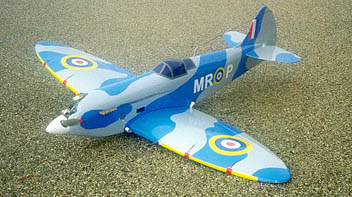

I have flown combat in Europe for some years. The RPM's are limited to 17.000 here. I used MVVS .15 and APC 8x4 and it gave 16.400 RPM or APC 7x5 and gained a few hundred RPM's more.
Milos
Adding a picture of my blue Spit from 1999.
