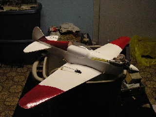

The CoroSpit gets my vote because it:
1) Is simpler to build (fewer parts).
2) Dosen't use balsa for the spars (more durable).
3) Better, but not great, scale outline (the "MiG-7" is actually a scaled-up MiG-3).
4) More paint schemes (the real MiG-7 was a 1 of a kind prototype painted dark green over light blue).
5) Hey, its a Spitfire!

The original Mike West "MiG-7" plans call for balsa spars. If you've used yardsticks, cool.
One thing that I should have mentioned is the CoroSpit turns tighter due to more wing area and larger wingtips. The very steep taper of the MiG tends to induce tipstalls at high Gs.

Well I started building a corospit modded to look like a P-40 but half way through I had an idea, So I pulled out the plans for the Mig (OH Demon the plans must have been updated, It does call for yard stick spars) Well anyhow I built a new wing and enlarged the wingtip cord by 1 1/2 " and now has slightly more wing area than the spit but is a slightly thinner wing so speed should not suffer as much, If it works out I'll post the changes, I just love the look of this plane. I plan to test fly it this weekend and I'll let you know how it goes, My brother should have his corospit there to compare the two, Need to get it all tweeked out for the funfly next weekend. Unfortunatly all I had left is yellow coro so I may be building another wing when I get more white, Maybe I'll build another Mig as a backup.

Got me test flight this weekend on the enlarged wingtip cord wing and man what a difference, Will post the changes soon but this thing flies great and no more snapping on high G turns

Enlarging the tip chord is always good for reducing snapping. However, with a 2610-class plane, you have to make sure the tip chord stays within 10% of the scale chord. If enlarge it too much, you might wind up with a great flying, but illegal plane.
