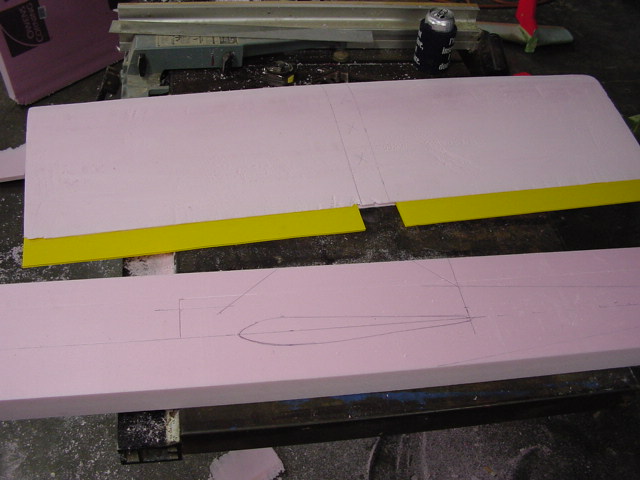

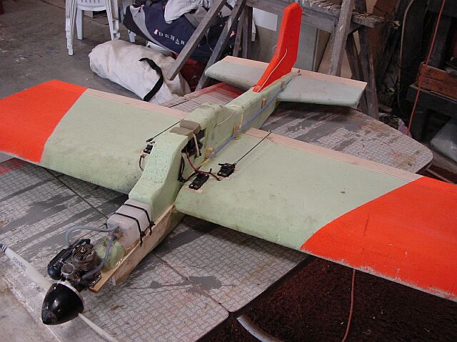

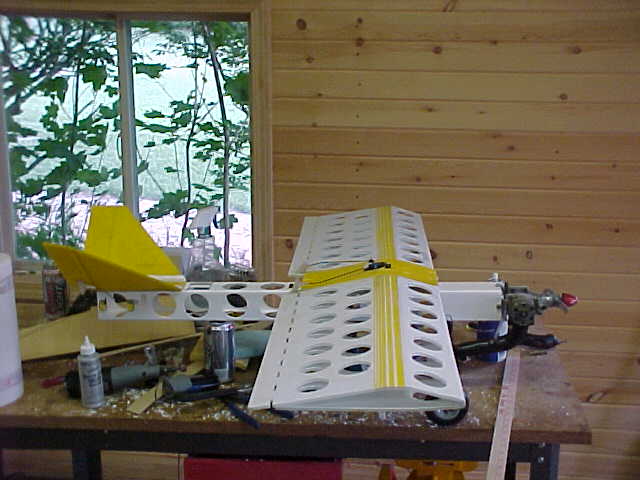

I think I just want to redesign my current version of a BASIC PLANE. I've built 5 of these each one an improvement over the the first. Unfortunately my last one which I have no pics of is the slowest of them all. (thicker wing/ overall weight is high) First pic is my first foamie that I built last spring. Second pic is simply the wing construction of my 4th plane. My 4th plane actually was the fastest but needed wing reinforcment. (that led to it's ultimate demise)
Posts: 4,987
From: Laurel, MD,
In your next design, go for more wing span and a longer aspect ratio. I can't tell what the span and chord is for your plane, but if you look at most combat planes, they have long, thin wings. That's mainly because long, thin wings are more efficient and turn better (even if they roll a bit slower). Also, with sticky stuff on the wings, the longer wing can help get a few extra cuts.
