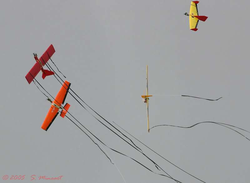

Try Texascombat.com and look under "kit sales". You may also find some usefull information at Georgiacombat.com. The photo I have attached has a "Falcon"(yellow/red), a "Rapier" (red) and a "Battle Axe" (orange). Rapier is available at http://www.MidAtlanticCombat.com. These run on OS .15 LA with MAS 8x3 prop. They are SSC (slow survivable combat) planes.
