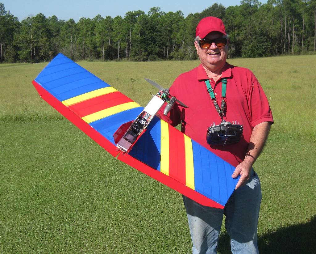

Well I snuck out at lunch to run a few tanks through the Gremlin.
Keep in mind I haven't held a radio in about 7 years......
First flight with the OS35, she lifted out of my hand and climbed right out. and kept climbing...... I was holding in about 3/4 down for level flight so I landed it and made a quick adjustment. After that I flew 3 tanks of gas without incident and was rewarded with 3 soft grass landings at my feet. Apparantly I even remembered how to index a prop....
In any case, many thanks to RA Cores for this killer kit. I was amazed that after so long, I was able to get back into the hobby without the pile of busted balsa to show for it. I need to get started on my next Grem soon so I am ready when the inevitable happens. Thanks again!

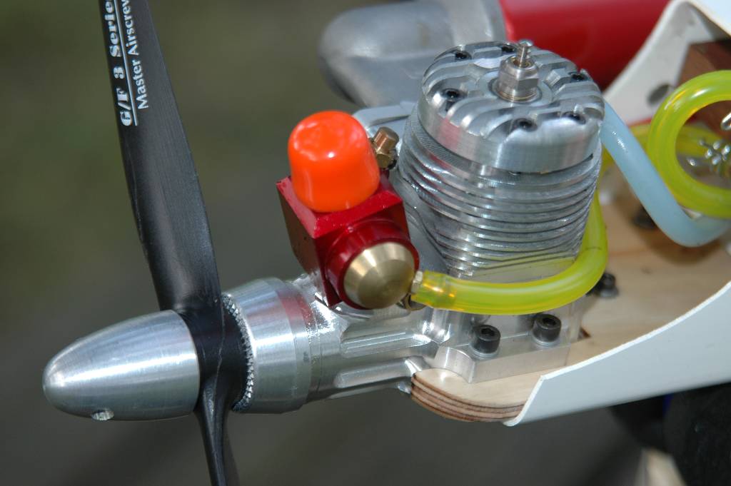

My Gremlin, finished a few weeks ago, is a ball of fun. I have a second one in the garage, ready to start on.
I have an OS .46AX on mine, which is overkill, but who doesn't like fast and vertical climb. The next one will have working rudders for snaps & spins.
Gremlins are easy to build and a ton of fun for the price. Mine is covered with colored packaging tape. The elevons and fins are in Monokote.
Yes, it is a Thunder Tiger muffler (or something else). I bashed the OS one.

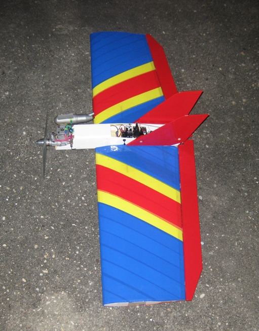

Gremlins aren't just for Halloween - but they do seem to multiply and take over the workshop!
All are powerd with .25's (ASP, OS-FX & OS-FSR) for our regional Open-B combat sessions.
Black & yellow is battle proven, the other two are recently completed back-up's.
All awaiting next years combat events!

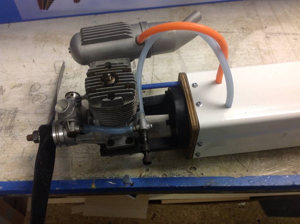

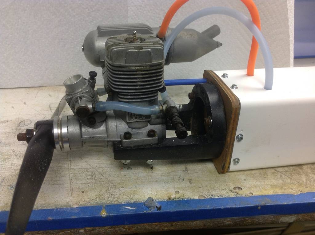

Awesome stuff! I too am building for the Spring. I just dont feel right if there isn't one Gremlin in some state of assembly on the bench.
The only problem I am having is keeping the motor mounts from cracking. They are recessed flush with end of fuse and after a gallon or so of flights I see hairline cracks between the motor mounting bolts (always left side for some reason).
Can you fellas share your tips for strengthing that area? I hesitate to make it bomb proof as throwing a new mount on just takes a few minutes and does absorb stress of less than steller landings, but I would like to reinforce it a bit.
TIA
TIA

jwottowa - I've been sitting back, watching this part of the forum as Gremlins are also one of my favorite planes too. So when you posted your question about reinforcing the engine mount I knew I had a photo to share.
I don't know what you're using to mount your engine, but I use 3/8 inch aviation plywood as in the picture. I've never had problems with mine. In fact the one in the photo has flown for almost 10 years the way it is. Although I'm not using the Jett 35 anymore (way too much engine for the Gremlin) any other engine, with this mount, and they seem to fly forever. Mike

What I do to keep the plywood from splitting is after I drill it all out I soak the holes and edges with thin CA which soaks in and hardens it. What ends up happening then is the PVC lets go so then I take either a 1/8" ply and duplicate the mount and sandwich the fuselage in between them. The other thing that helps is to have a predrilled replacement in your flight box. Since I did that I have never broken the plywood at the field, and duct tape can hold the fuse together for that "one last round"
BTW: This month is the 20th anniversary of the publication of the RCM Construction article. My phone started ringing 11/8/1992 when the December 92 RCM issue hit the subscribers. it was almost 2 weeks later before i got a copy or three off the newstand

ORIGINAL: rcplanes711
I now mount all my gremlin motors this way. They have even serviced a lawn dart. I got tired of making mounts.
P.s. .46 work just fine
