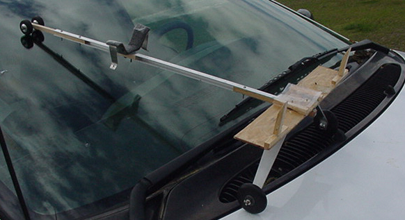

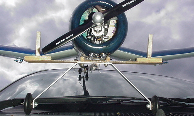

Anyway... my dolly-launcher is built and working very well. I have a few pictures and would be happy to guide others to the world of: "The Dalai Launcher".
Attached are pictures of the Dalai-Launcher. Some things to note;
The length of the entire system allows the two rear wheels to extend beyond the tail of the Combat Corsair when the wing is pushed up against the two wing retainers. This allows the operator to step on the wheels as a "foot" brake until it is time to rev-up and fly off.
The height of the wing retainers is 2.75 inches (sorry I still have not converted to metric when taking quick measurements... don't know why thought... ) and they are made of balsa and covered with two coats of epoxy in order to make them sturdy and slick. They are also rounded at the top. They are epoxied onto the cross-member or "load-bed" ( an eighth inch thick piece of plywood covered with epoxy) of the launcher and are approximately 13 inches apart so that they catch the Combat Corsair wing at the Gull point.
The main front-to-back rail of the launcher is made of motor mount maple wood and aluminum trim from a screen-door molding that I got at Home-Depot.
The dual rear wheels are large tail wheels... probably Du-Bro and it is effective to have their sturdiness, weight and balance.
The front "saddle" is made of the same balsa stick separated so that the cowl of the CC is laying in between where it has a cushion of R2000 silicone glue fitted to its shape. This fitting was done by covering the glue with a plastic sandwich baggie and laying the CC onto it and watching to see that the big blob of glue didn't run off.
The rear saddle is made of an inverted aluminum landing gear and covered with some foam.
The front wheels are from something in my bins of old stuff purchased from guys who are probably dead by now. They may no longer be available but I like their tracking ability in the grass.
If the Dali-Launcher and your Corsair veer off to the left or right on a simple, slow, ground test you simply bend the major front-to-back rail so that it will steer in the opposite direction. Keep trying until it tracks in a straight forward manner. It is important to do this.
Have fun...

If done properly there is nothing unsafe about a hand launch. It may be unsafe for some and those are the ones that need some sort of launching device. In my days of flying 2610 I never had one incident of a failed launch. I launch underhand to keep fuel out of my eyes and I keep my thumb on the transmiter stick at all times to fly as soon as I launch. It is all about technique.
When Air-kill was in business he sold plans for a launcher. I have seen and used one and it worked good. A little too good! It could cause your engine to go lean and sag at the moment of truth!
Your dolly is a good idea. It is just a play on what the Control line speed guys use to launch thier planes. May be a little tough on grass.

Although I have hand launched many different model aircraft, this little round Corsair with caster oil sprayed on the fuse from the exhaust, leaves it slippery and without purchase for even my big hands.
Do you have the GP Combat Corsair? Have you tried a hand launch of it? If you have, please... show the pictures!
The Dalai Launcher keeps fuel off of me and the Tx; and, every time the DL shows up at the field everyone wants to see it do its thing. It works, we have fun.
