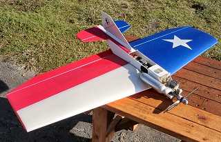

Default Pic of modified Gremlin with Tail
That design has been popular in the Dallas area for the last three years. Here's one of the nicer ones. They do fly sweet!
That Texas flag plane looks alot like a design than one of our members fly thats called a Predator. The wing is more swept than the Gremlin,... but it sure looks good, and the one ive seen flies great. I actually trimmed the fin by 1 1/2 in to decrease drag somewhat. But the turn radius is suppurb now, which in combat is what ya really need.
