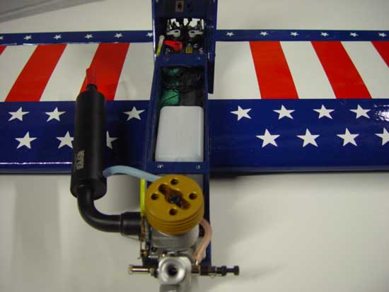

Old 01-03-2004 | 10:07 PM
Joined: Jun 2003
Posts: 16
From: Dover, PA
Default RE: Engine for Gremlin
You might want to try the MVVS .26 Combat Wombat. I mounted it on our 36 in. version, the mini-gremlin. It spins a 9 X 6 MAS at 16,000rpm. No radar gun but very faaaassssssssssst. Ask davesim. I know it will pull a full size 48 in. Gremlin with ease.

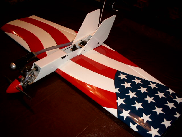

ysrcflyer's Avatar
Joined: Jun 2002
Posts: 219
From: Plover, WI
Mine is not legal but it sure is fun doing a low level pass at full throttle.
YS 45 for power.

SeacretsOceanCity's Avatar
Posts: 678
From: Georgetown, DE
ysrcflyer, That grem looks like it would be nose heavy. Did you have a problem with that?

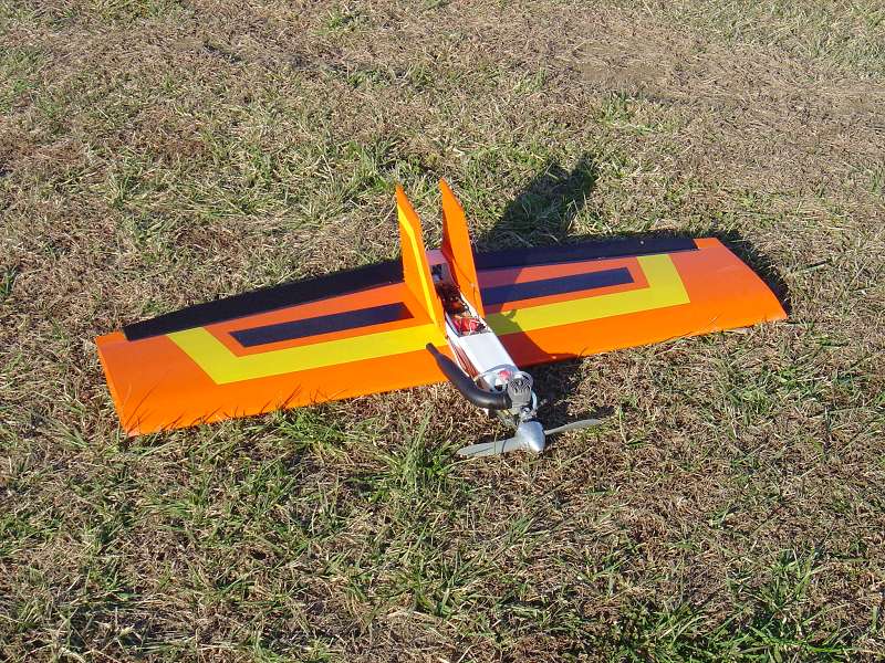

dioncuda's Avatar
Posts: 326
From: morgantown, KY
I use a TT.42gp,with macs one piece pipe.I am going to use at fun fly combat.[8D] I really like the way it flys.

ysrcflyer's Avatar
Joined: Jun 2002
Posts: 219
From: Plover, WI
I had a OS 25 on it originally. Not enough power for me.
I had to slide the fuse back about 1/2 inch to rebalance. Other than that no problems.
