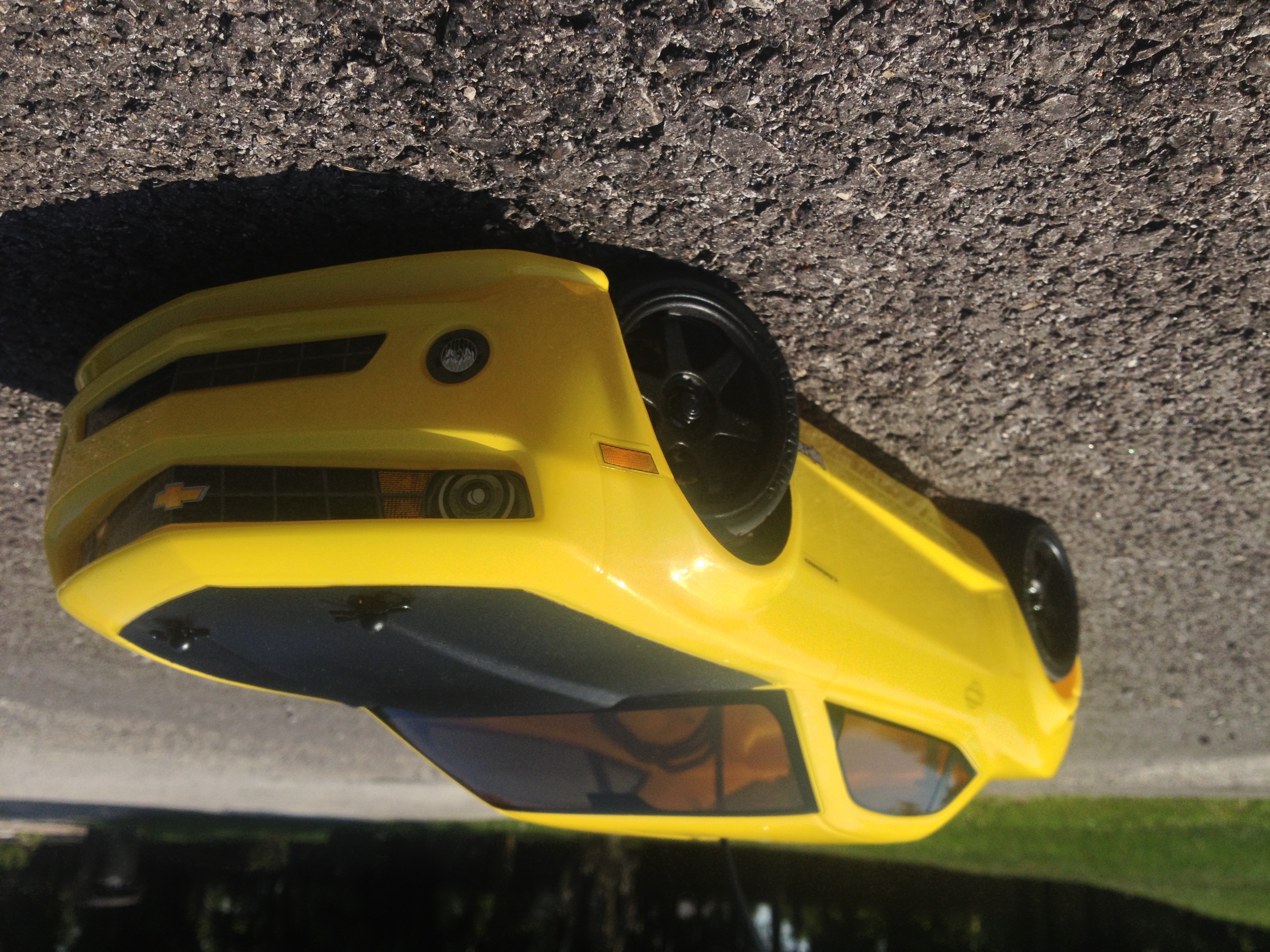

Well guys finally got my car yesterday and extremely happy with it! Except....the body it personally looked tacky to me(no offense to those that like it otb) and I felt like it just looked like another rc car. So I decided first things first let's put some personal touches on the car and make it my own. With out further adieu my hpi sprint 2 flux Camaro.
First lets get rid of the ugly stripes

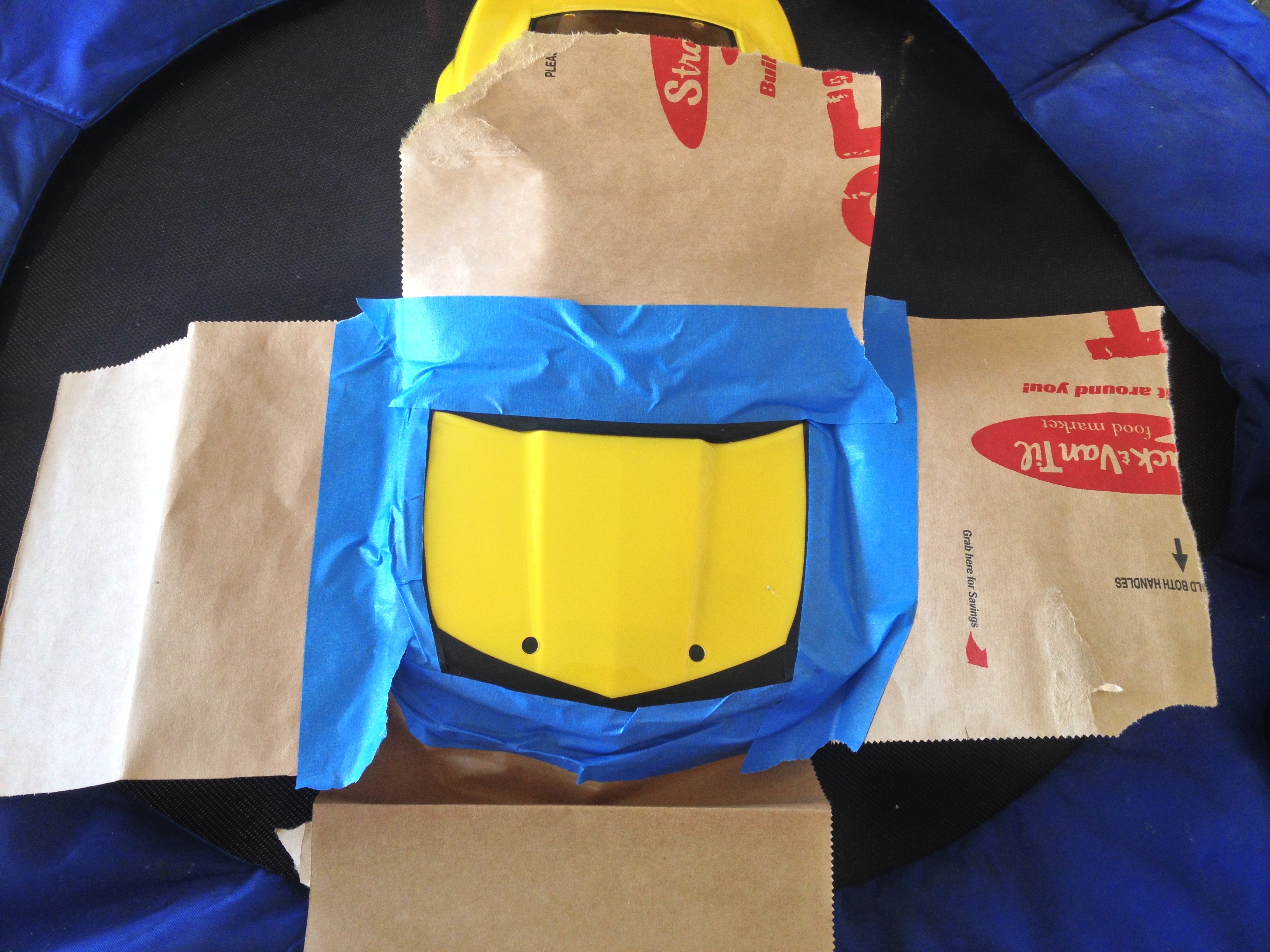

Next it was time to mask off the hood and clean the vinyl residue
I did use electric tape underneath painters tape because it game me more accuracy with the hood lines.

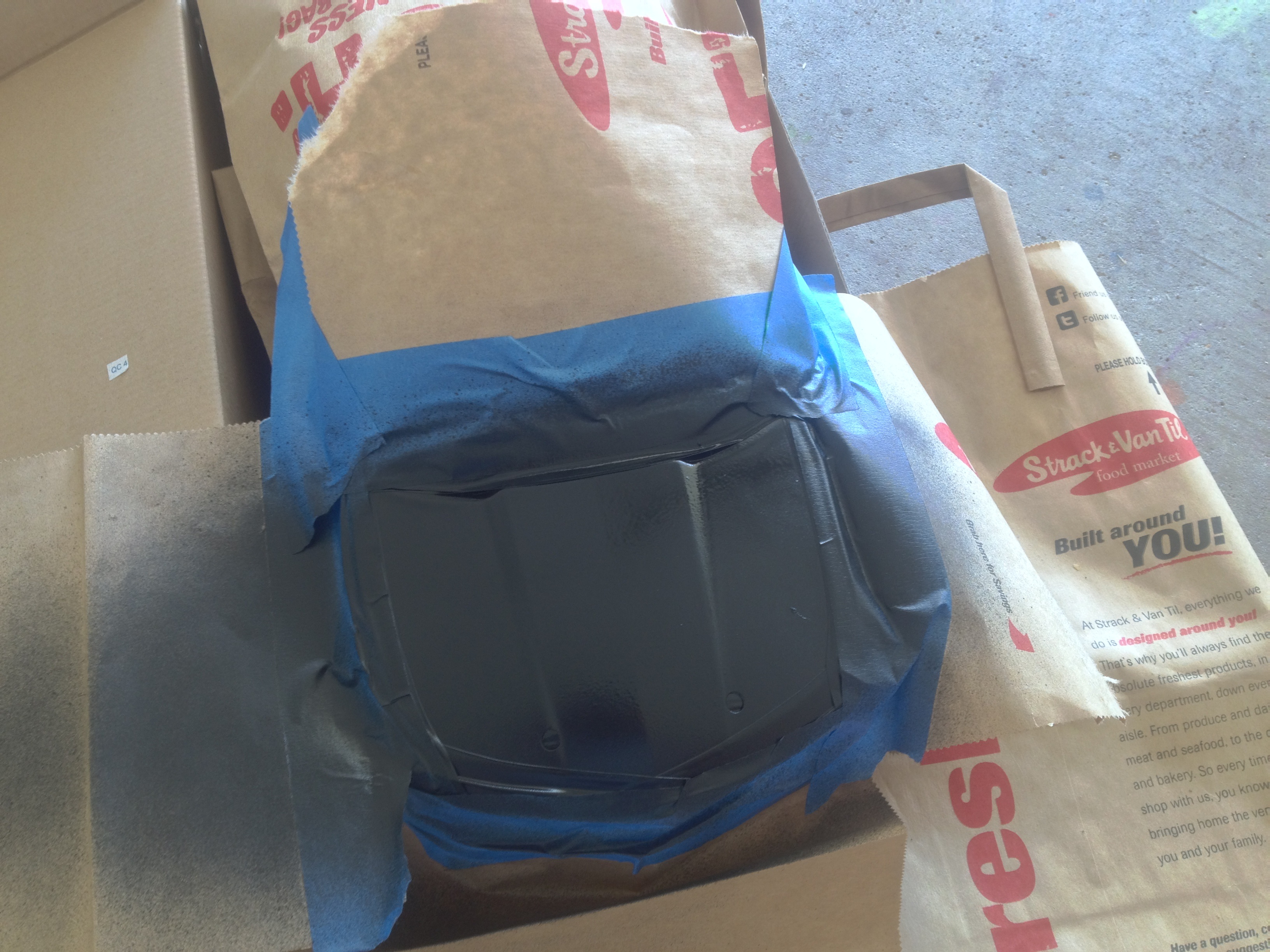

And now came the plastidip. I put on 4 coats 1-2nd heavy 3rd medium 4th super light.

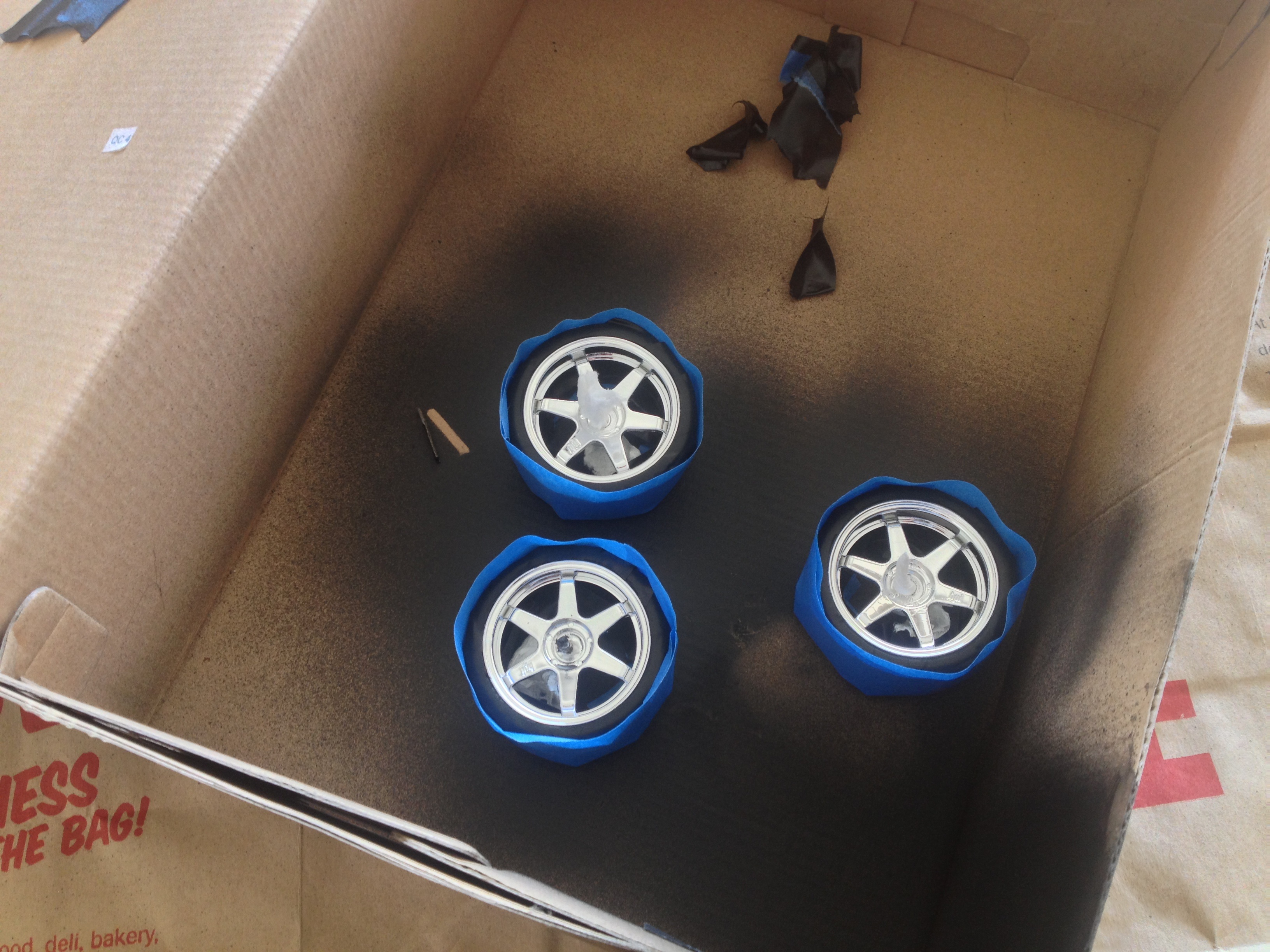

After the hood was done I decided that the wheels needed some attention too
Before

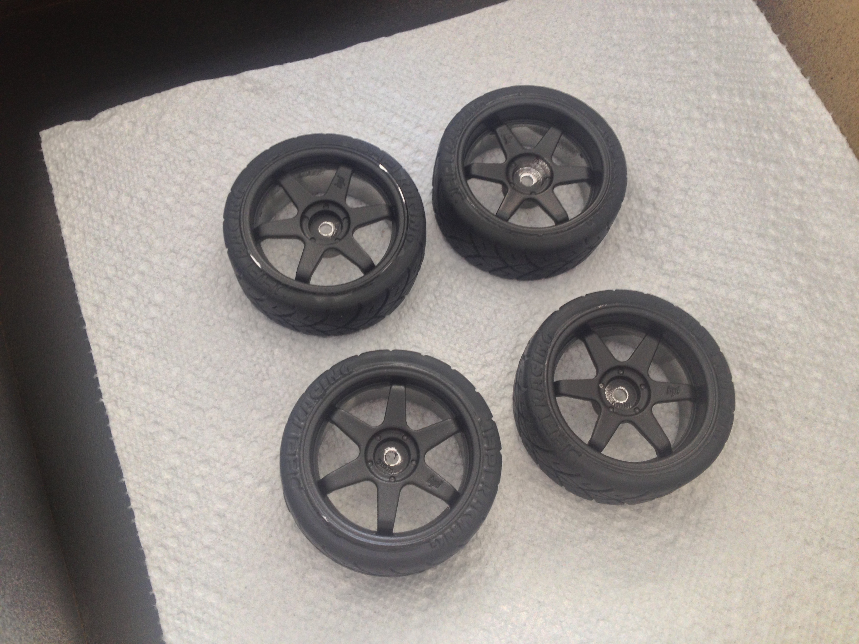

After
The wheels received the same exact coats as the hood and was happy with the outcome (even tho I did mask the first wheels crappy

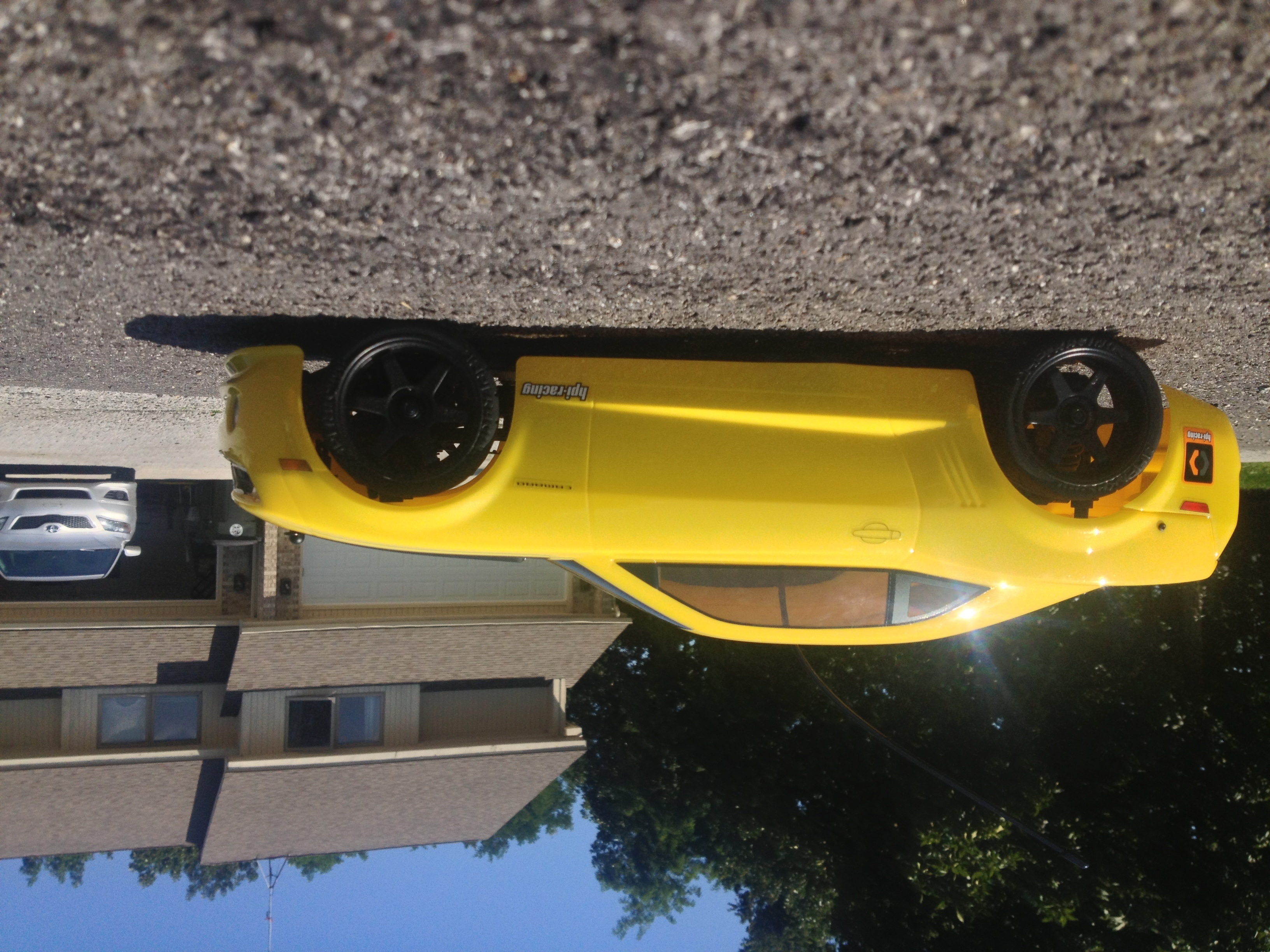

) the final product was a cleaner and more aggressive look this car deserved and recommend any one who got the same car to try it out for themselves. It was extremely easy an cheap, wouldn't cost you more than 5$ for a car that looks 100$ more expensive IMO.
the end product
Hope you guys love it as much as I do!
