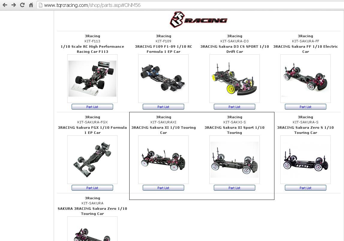

To be quite honest, ANY of those would be a great choice (with the exception of the D3). As much as I like the D3, I probably will never get one, based solely on it's overcomplication. It has too many belts, the belt adjustment feature is too complicated and difficult to adjust, it also doesn't come with the requisite parts to make it complete, and it's balance is waaaay off.
The Sakura XI is the popular chassis right now, and places like TQRC Racing (where I go for almost all my parts) are stocking tons of parts for it.
The TA05 is one of Tamiya's longest running models, and any TA05 model will be good. There are a few carbon chassis kits available for just about all TA05 models, and the TA05 is one of the best all-around chassis for drift and grip driving.
The TA06 departs from the TA05 series, and there's not much from a TA05 that will fit a TA06, apart from some suspension parts, but the TA06 is perfectly balanced, right from the start, and requires the fewest option parts to make it competitive. As a drifter, it requires only a spool for the rear, front one-way for the front, but has an issue with motor fitment - some BL motors will not fit it, based on it's rather small motor bay. Brushed motors will all fit, but it also restricts gearing choices, as well, but if you use it for drift, that little problem won't be an issue, since lower gearing is what should be used, anyway.
The TA06 also now has two or three carbon chassis kits available for it. I have the RSector kit, and it's probably the best of the lot.
The above choices (with the exception of the D3) are all interchangeable from drift to grip and back again, by swapping a few parts, and are all able to be CS'ed like the D3, when you are comfortable enough to try it. Modding for CS will take some study, as belts and pulleys need to be replaced with suitable sizes to accomplish CS, but to do so doesn't take much more than that, so any of them will grow with you, since belts and pulleys are all pretty much standardized, and Tamiya themselves, make pulleys and belts from other models, that will do the job. 3Racing also does, so the XI can be CS'ed, as well.

The XI is a great starter for you!
As stated, it has a bunch of option parts, and all can be had from TQRC (those that aren't out-of-stock, it IS the popular chassis right now, after all!), which have the lower pricing of many online vendors, domestically. I've also visited their shop/track, and it would surprise you to see just how small the room they do all their parts orders from! It's a hole in the wall!
As for the better parts for the XI, the front one-way is a good start, as is a spool for the rear, and getting many of the main chassis parts that are plastic replaced with carbon or aluminum parts would be adviseable. There is nothing wrong with those plastic parts, but if durability is a concern (or just longevity, since on-road chassis aren't jumped or otherwise abused, unless you insist on running on filthy/rough surfaces consistently), aluminum parts for the main chassis are a good idea. They also make the chassis look purty, which would urge you to treat it better!

I went to TQRC's site, and see only the D3, Zero and XI Sport.
If there is any difference, it would be the sport has an FRP chassis, rather than a plastic or carbon chassis. Fiber-Reinforced Plastic chassis are more durable, and has a bit more flex, than a carbon chassis and are slightly more durable than a plastic chassis. FRP chassis are also not electrical conductants, so you won't get "glitching" with them, as some servos do, when mounted on carbon chassis.
I have a couple of chassis made from FRP, and have not had any problems with them. They aren't as nice as carbon chassis, but they work well, and are at least a step-up from plastic chassis.

Ahhh....I see.
The Zero and XI are two different models. The Zero S is about six years old or more. The XI is the "updated" version, but doesn't share many main chassis parts with the Zero. In TQRC's parts section, you'll see parts specific to both models. Only if you see parts labeled as "XI/Zero" are they compatible with each other. Usually, like Tamiya, only suspension parts are compatible, but the rest between the two won't be.
