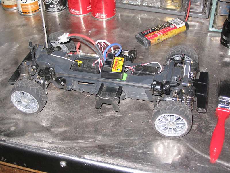

pyrodon's Avatar
Joined: Apr 2005
Posts: 307
From: , QC, CANADA
Default RE: how do you make drift tires
this is my TL-01
